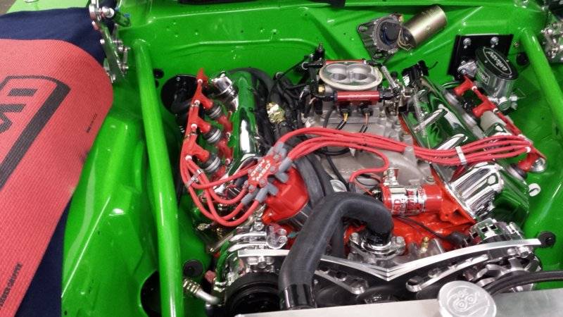

I understand EFI systems and how they work. Also how to trouble shoot them. The only aftermarket setup that I have personally used was a Fast on this 472 Hemi.
Once it learned it ran awesome. Started right up. Great idle. Crisp throttle response. No smelly exhaust and flowed plugs. I fell in love.

Nice looking set up, I just sold my fitech and am going with a Holley sniper stealth 4500. My next engine I want to try out summit brand self learning efi kit, priced at like 500-600 I think? With a warranty and summit customer service you can’t beat it.
