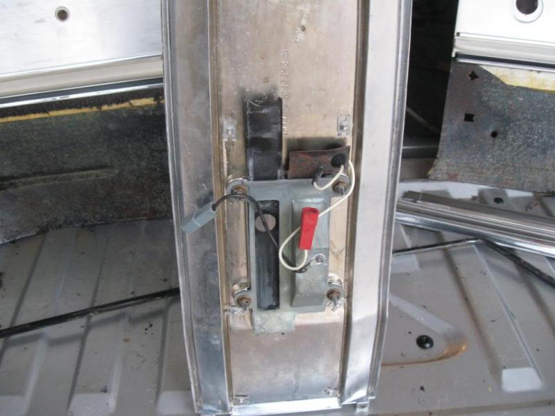

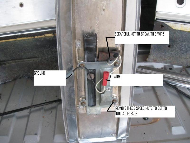

On the shift indicator. Remove the lid, then remove the 2 speed nuts holding the indicator to the lid. the plastic is sandwiched in between the indicator and lid. Once they are off you can clean and polish the plastic. Also I took some cleaner wax and lightly polished the surface of the indicator. It will brighten up the letters nicely. You can also do that to the gauges in the dash.

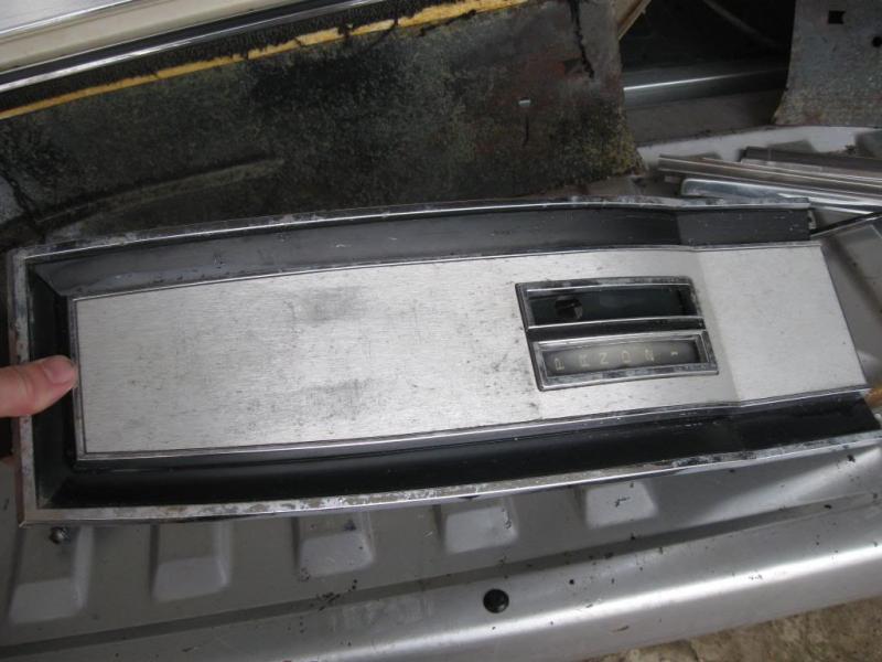

I found a pic of the center console top plate from my parts car. There are 4 speed nuts in each corner. Remove them and you will be able to clean the EL PRND21 face. If your careful it will be OK. Did this to mine last year, amazing how much brighter the EL once the face is cleaned.

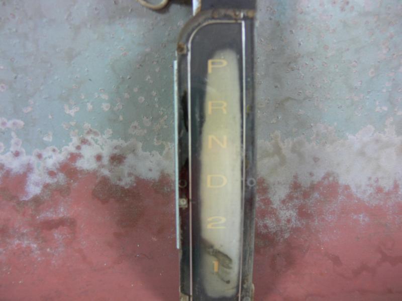

hope to add picture of the gear indicator, looks as if the EL itself is discolored, Very concerned abt attemptingto seperate it from the metal backing or the plastic cover? should I CHARGER 004.jpgbe ?
Wow, that is messed up. Was there a plastic lens, did it come off?
The once black strip with the PRND21 stays on the metal strip. The EL strip is under that black strip, don't remove that. You would try to wax the black strip.
Not sure if anything is gonna bring that back to life. Give it a try but if you have no luck I have one on the top plate pictured above if you want to go that route.
can you show pic of your indicator ? Yes mine was intact, so not sure y so discolored :-(......20+ in Junkyard, then 20+ in my yard certainly didn't help............
Hmmmm...mine isn't much better. This is the only pic I could find. I could take a look at it again and get a better pic if you want.
