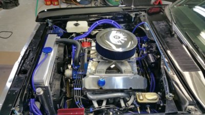

Aluminum 3 pass rad and a single Spal 16" pusher with no shroud.

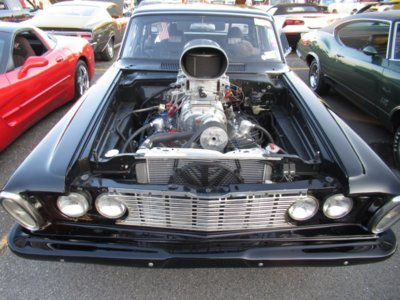

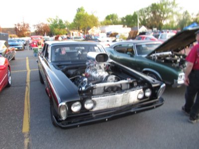

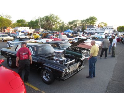

I was beating it pretty hard tonight! 1st cruise night,hit 2 places and nevet went over 180*
