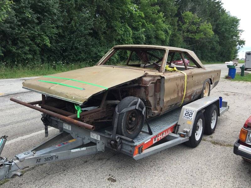

I've been asking about this car for years, wanting to restore it or at least get ahold of it to get it stored back indoors. This past August I was finally able to fulfill that wish as my uncle allowed me to take it. My dad and I spent a Saturday getting it rolling, which entailed putting correct torsion bars in it, finding some used 13" used tires, hooking up the steering, and of course clearing out a couple wasps nests :eek:. From there I loaded it up on trailer and filled the bed of the truck with any parts that went with it and towed it back to upstate New York. It's now living safely (and more importantly dry!) in my insulated and heated garage.

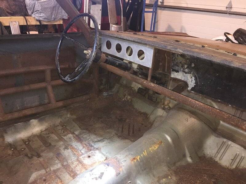

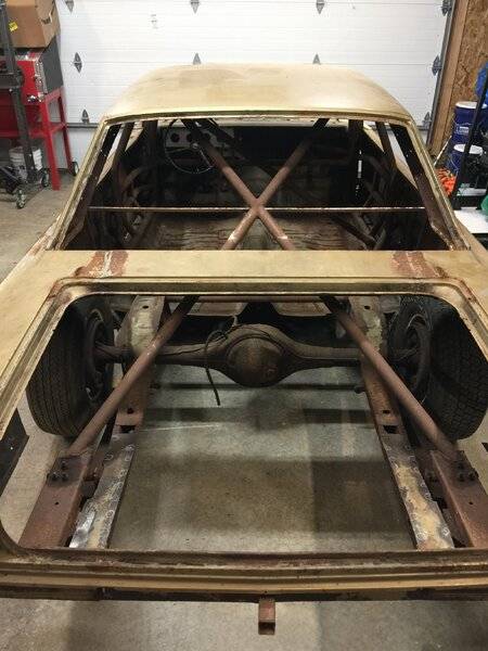

Right now the car is in the state it was left when work on it stopped. It had been totally stripped to just the body, floor pan, and frame rails; inner fenders, trunk pan and extensions, door guts, etc. are totally gone. Even the hood and trunk lid are just the skin with none of the factory bracing. It has the roll cage mostly built. The only area not totally finished is the rear section where the upper shock mounts need to be located, as well as bars to mount the seat and belts to, and a few other miscellaneous bits. It has a Ford 9" rear end that has had the sides evened up on it. The front suspension was based on the Chrysler kit car, so the upper A arms have been cut and welded to help with camber, there is a splined sway bar, and the shock mounts are beefed up and set up for tie rod end Monroe shocks. The front engine mounts have also been moved to center the engine. Speaking of engines, the car came with two 340 engines, unfortunately neither is the original Norm Nelson race engine.

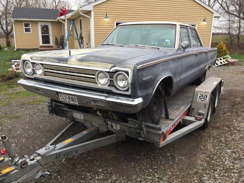

Between August and now I had been focused on finishing a couple motorcycle restorations I had been working on previously in order to clear up my project slate, so I am really just getting started. I drove to Texas around Thanksgiving to pick up a clean 4 door 67 Belvedere that I intend to use as a donor. The race car is surprisingly solid for as long as it sat. The main rust areas are the quarter bottoms, rear bumper mounting area, last 14-16" of the rear frame rails, and a spot in the passenger side footwell. Everything else - from my preliminary judgement - is only surface rust. I was even able to climb in and sit on the floorboards (aside from the one bad spot) without any issue. I already know as I tear into it more I'm sure I'll find more rough areas though, so I'm keeping my expectations in check.

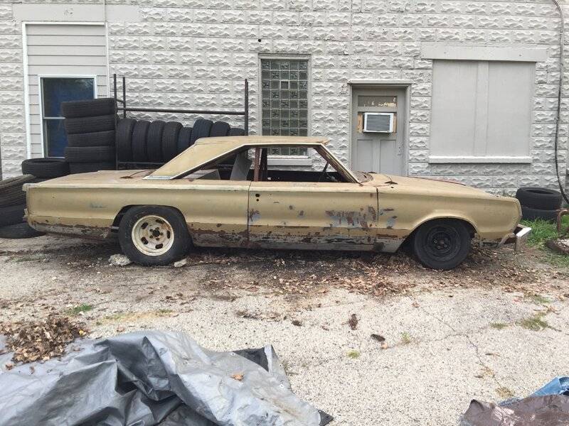

As it sat beside the shop:
Loaded and ready for the journey home:

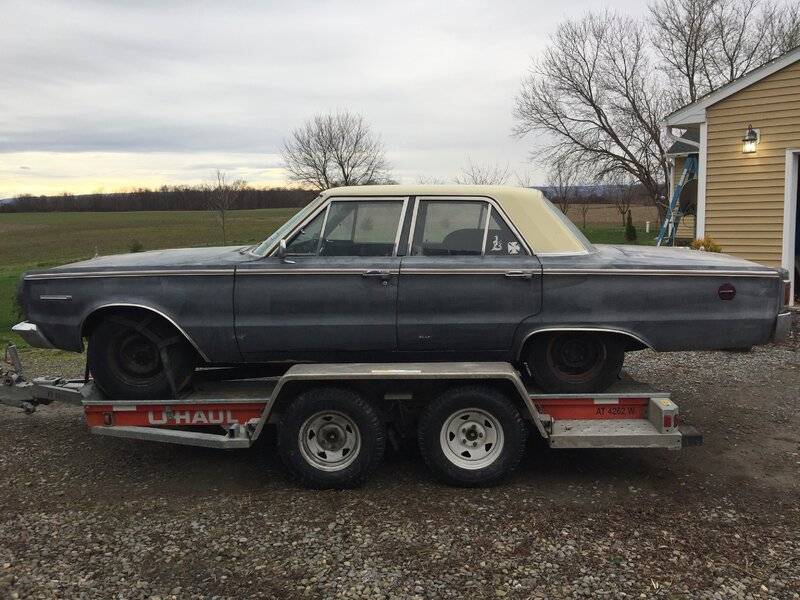

Donor car still on the trailer after getting back from Texas:

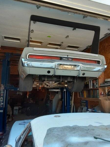

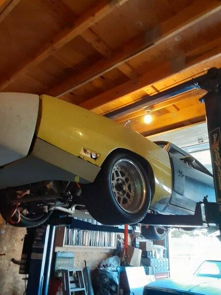

Cool project! I got a stock car build in the works too. Are you going to build it to race,or drive on the street? My car is a 70 Charger R/T body on a circa 2005 Laughlin Nascar chassis,with a Daytona kit on it. I plan on building a 200 MPH Hemi powered Daytona stock car that I can drive on the street. I am a bit outside my wheelhouse with setting up a stock car. If you find yourself needing inspiration.there are a few good episodes of Roadkill where they put stock cars together and drive them on the streets!
View attachment 1044290 View attachment 1044291 Cool project! I got a stock car build in the works too. Are you going to build it to race,or drive on the street? My car is a 70 Charger R/T body on a circa 2005 Laughlin Nascar chassis,with a Daytona kit on it. I plan on building a 200 MPH Hemi powered Daytona stock car that I can drive on the street. I am a bit outside my wheelhouse with setting up a stock car. If you find yourself needing inspiration.there are a few good episodes of Roadkill where they put stock cars together and drive them on the streets!
