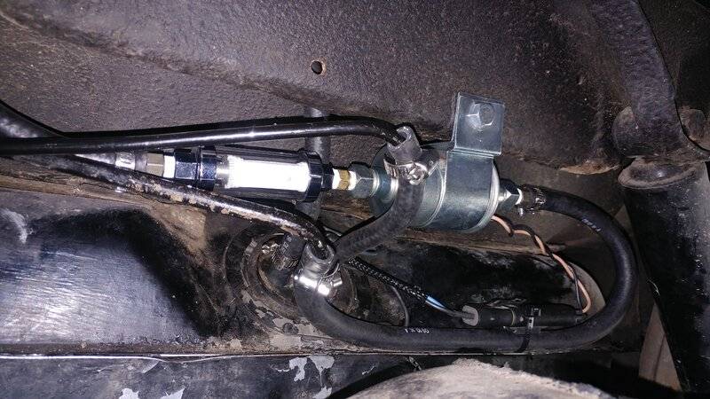

I added this setup to my car a couple of years ago and works great.
Pump is by Airtex, marine pump # E8251.
Be sure and have a fuel filter before the pump. I got one that uses replaceable filter elements, is made by Spectre, universal fuel filter #2369.
I used 16 gauge wiring thru a 10 amp fuse from a switched (ignition on) source point.
That’s exactly what I’m after, I hate to crank the engine that much after it sits for several weeks.
I was advised to mount the pump as close to the tank as would fit without interference, this seemed the best spot in my car. It can easy be switched back if needed.
I also have a 1/4" return line coming from the fuel filter at the mechanical fuel pump plumbed into the tank thru the fuel sender face plate.
