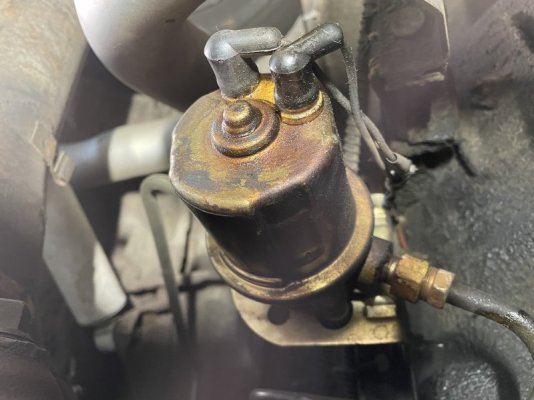

Working on the Coronet and noticed an on/off switch in the glove box. Followed the wire to the rear of the car to discover an electric fuel pump. But a mechanical one is also installed so why would it be necessary for the previous owner to also put this pump in too? IMG_2755.jpeg

Makes a bit more sense with these good answers. It is not a Carter pump so I think the car still ran with it shut off. It looks really old so will probably end up removing it and putting everything back to stock.

That IS a Carter elec pump [ or Federal Mogul who bought Carter ]. But Carter design, lasts forever. I would ditch the mech pump & just use the elec pump. Mech pumps are NOT designed to pull through other pumps....
are you sure that's not a carter pump?
