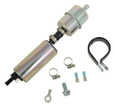

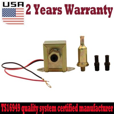

I would go with either the holley black pump or a Aeromotive fuel pump. For a return regulator go with Aeromotive.
These work well. Hook it up to a momentary switch, prime the carb, and bingo!
Holley has a nice one as well. https://www.summitracing.com/parts/hly-12-427
The cylindrical one with the filter attached is a Airtex I believe. (E8012S)
