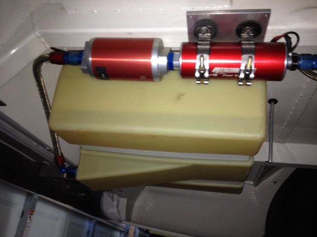

I don't have exhaust near the pump but it's just mounted to aluminum plate on frame with some rubber isolaters.

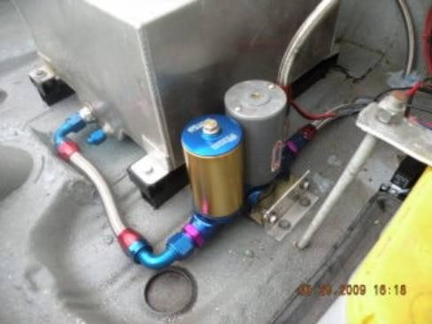

Just something to keep in mind. Mounting depends on the pump you have. A lot of pumps are pusher pumps. Those manufacturers recommend you mount the pump close to the tank and below the sump/tank outlet. It's not that you can't mount those style pumps elsewhere but the short period of time they run dry at startup will affect the pumps longevity.

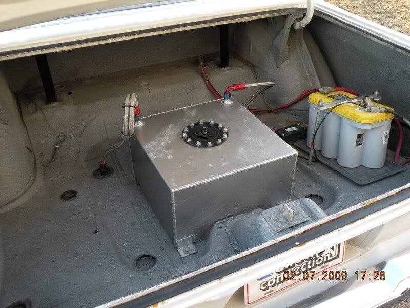

According to Magnafuel and Product Engineering a electric fuel pump should never be mounted under a car. Moisture, rain, burnouts eat up the life of a fuel pump. They all recommend to mount inside the trunk. I earned the hard way many years ago.
