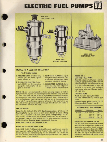

I've always liked the old Stewart-Warner 240A pump.....its adjustable pressure...see below
JUST A THOUGHT.....not inexpensive....but reliable great for carb engines.....

True....it's an old design, noisy, very likely the S-W was sold to probably a Chinese company....but....available on line as used or refurbished......it, like me and vintage wine.....just gets better with age...??...

What I didn't like about them they were noisy (aren't they all) they ran with an on off switch. Like turning a wall switch on and off. Have a couple someplace.
The S-W pump can be controlled via a relay, whose coil is energized when the ignition is turned on, powering the pump...no separate on/off switch is required...somewhat like auxiliary cooling fans...YES...they are noisy...so what...just like Flowmaster mufflers or open headers...a good noise. Very low Amp draw (8 amps).at max pressure & max flow..
Plus the pressure is adjustable...no separate regulator is required or needed...just something to think about.....

The switch I'm talking about is in the pump where the wire goes in. When you turn pump a shaft goes up to pump gas. A cut in the shaft the tip of switch rides in shuts the power off. Shaft drops and power is turned back on.
You jump out any switch on the pump and control its operation as I suggested previously. The circuit is 12 volt in (or 6v or 24v as you prefer) and case ground, thru a separate wire to the chassis or battery negative. My old 240A pump did not have the switch you noted....only the power I + ground...yes its a positive displacement piston pump...a lot of the new stuff is a centrifugal/vane pump.designs....
