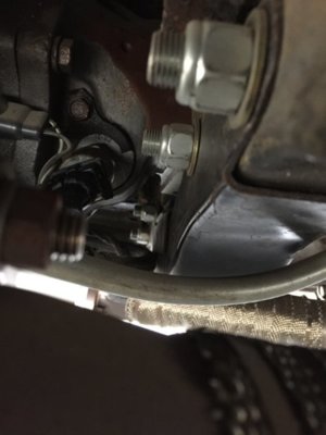

To the left at the top is my reverse light switch, lower on the right is the electronic speed sender

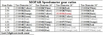

I was just looking at the speedo gear drives. How do I figure out which color/size gear wheel I need?

Rear gear size, 3:23’s, 4:10’s, etc with a 28 inch tall tire.....there’s a chart for it, give me a minute.
There's a start
there are calculators on the web also.

So the adapter I get will have like 32-38 on it and that needs to be at 6 o clock? I think my tires are 26" and the gears are 3.55. So 36 teeth and red color...
The adapters take different size ranges - just rotate to the 32-38 mark as shown. :thumbsup:
