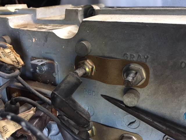

I did narrow it down to a purple wire and gray wire at the cluster. They have a black molded elbow connector and plug onto a threaded male post. Each one was part of the draw. I have not researched what these wires are for yet, but i will try to decipher the wiring schematic. I'm horrible at reading those, so if anyone can offer help, i'd be greatly appreciative.
Also, i see they are labeled at the back of the cluster, This one says "RED" but it had a black wire going to it. (see pic)
okay,.... the gray one is for the fuel gauge, and the violet is for the oil pressure gauge.....
I would assume neither of these should be getting power with the key off,... strange thing is neither of them worked when the car was off. ???

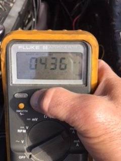

Just trying to help here. When I was chasing parasitic draws at the dealer 25-30 milliamps was within spec. Think about it, thats 25-30 thousanth of an amp. Not much. Anyhow some draws would come and go, read freeking computors. The special tool required was a Fluke 88 IIRC and set to a Min-Max record function. We would leave it hooked up over nite and the see what the Max draw was for a lets say 12hr period. Now I realize our older cars have no software ect, thank God. Could be somthing like a diode in the alternator going south. We had a rash of trunk lamp mercury switches go bad and keep the lite on, that was a bit less than .5 amp. Enough to kill a marginal battery over nite. What kind of meter are you using? Dont want to question your knowledge just throwing this out there. Hope you get your issue solved.

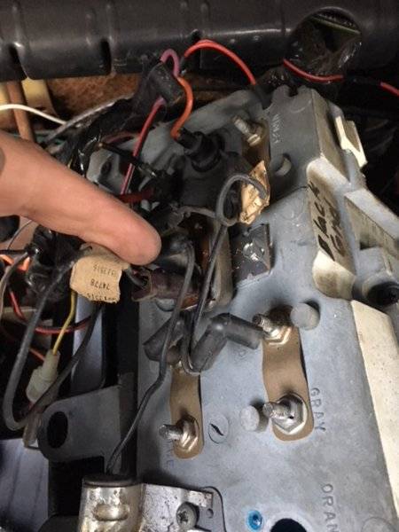

moving right along..... what is this little metal box. Constant power goes to it from the back of the Ammeter, and whatever it is its causing a steady pulsing of 12+ to the fuel, oil pressure gauges.
I noticed when taking my amp draw reading, the draw was pulsing.
Yep, that's exactly what i'm using. And i'm seeing that half an amp.
Yup that IS 1/2 amp. Or close to it. Not familiar with a 71 Satty but is it an IP voltage regulator you were pointing to?
