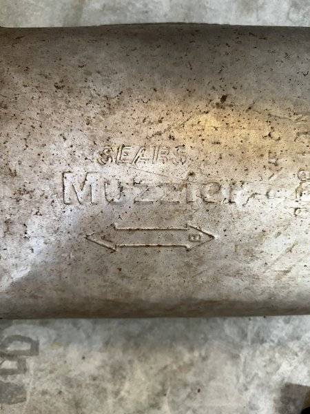

  • Muffler recently blew out, but I am certain it is from it being clogged up and it is a coincidence.

(Threw in a picture of the blown out muffler for laughs. Check out the brand)

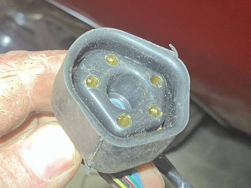

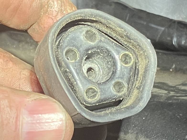

I had an intermittent "no spark" issue that I'm pretty sure that I fixed.
Old plug:
New plug...
The brass terminals were stretched out and corroded on the old one. I changed this some time last year and have not had a single "No spark" issue since.
