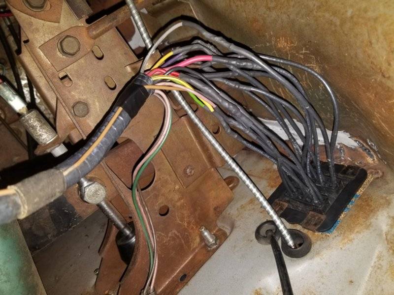

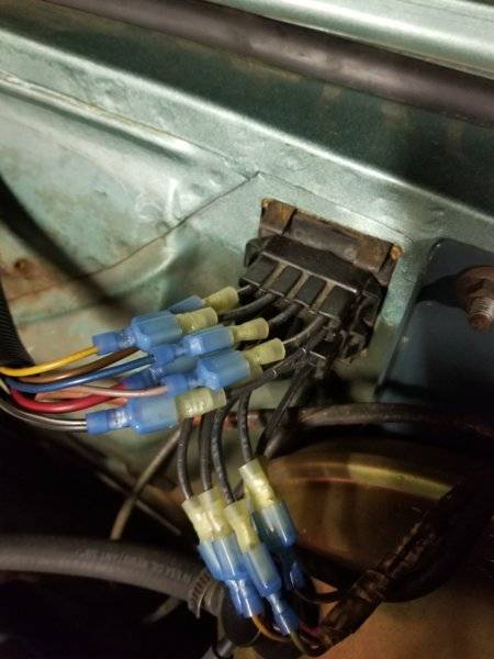

Can you post a pic of the repair you made to the bulk head? I don't fully understand what you mean by adding spades. It's it poss something is shorting in the bulkhead now? 100 percent sure you got everything where it should go? Any melted terminals?

I soldered all the wires under dash and then added connectors in engine bay. I'm confident it's all correct, I was very careful labeling everything and the car started and ran perfectly for a minute or two in between periods of not working right. And then now it wont start at all. But it cranks with full power and I have spark. I dont think it's a fuel issue. Could it be ignition switch somehow?
