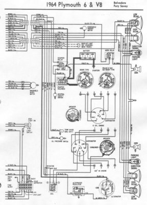

electrical issues, dimming lights, occasional stalling, rough idle at stop

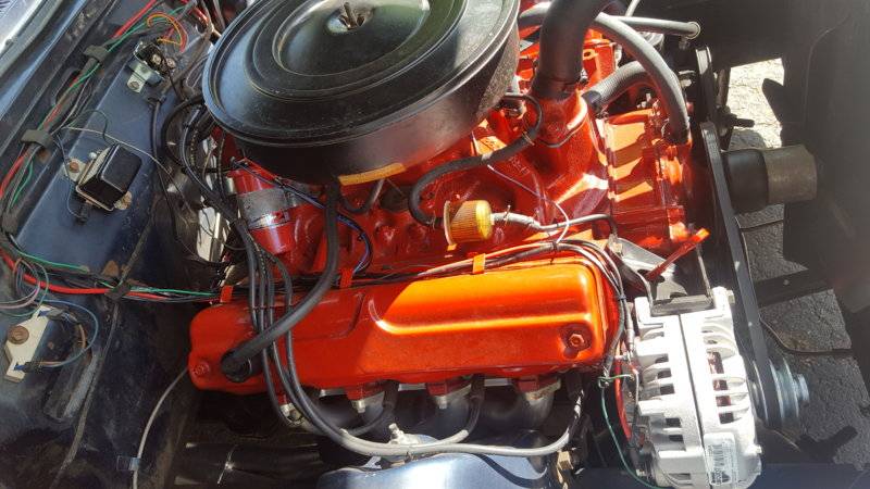

I'm thinking it's the alternator which has those modified brushes installed

I wrote up on some thread before what I did with the charge wire. I believe it was a 10 gauge wire directly to the starter solenoid with 6 inches of fusable link. I cut out the original black charge wire from the alternator, moved the red wire from the starter relay from G to F. Now power comes into the car via the black wire. I disconnected the ammeter, spliced the black wire to the Accessory Circuit Breaker.
The red wire no longer does anything, so I taped it off at the ammeter, and took it out of the bulkhead and taped off.

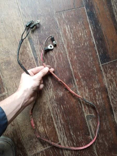

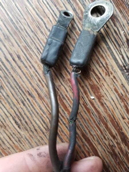

I may have narrowed the issue down to the two wires which go from the STARTER to STARTER RELAY. I'm getting the 0.8 voltage drop there. So either those two wires are dropping voltage or the starter itself is somehow causing the voltage drop.
I am going to remove and inspect those wires
Do you have the clamp on style battery ends? If so, corosion can work its way up the wire
My battery cables are brand new and I soldered them to nice battery terminals. I have a good battery ground to body and the battery cable to that goes to starter shows a very strong connection (only 0.04v drop... less than a tenth). Its only showing a significant voltage drop of almost a whole volt (0.8v) from the two wires that go from starter to starter relay
That sounds like a plan, could have break/corosion you can't see
Ya those two wires aren't looking too good maybe replacing them will do something
