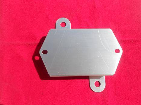

Buy a Performance Mopar electronic conversion kit. You can mount the ign Module on this bracket for a "factory look" it uses factory attachment points so you wont have to drill holes in you car to mount it. I make and sell the brackets - PM me if you are interested in one, I have some ready to ship. View attachment 1332542
What holes does it mount to meaning, what was there before this bracket?

The mounting bracket was used on cars that had factory installed electronic ignition. There would be no mounting holes on your car for this.
