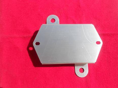

Buy a Performance Mopar electronic conversion kit. You can mount the ign Module on this bracket for a "factory look" it uses factory attachment points so you wont have to drill holes in you car to mount it. I make and sell the brackets - PM me if you are interested in one, I have some ready to ship.
