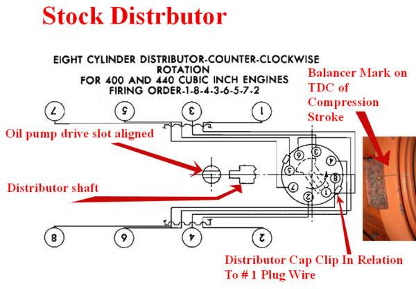

See my question about installing the distributor EXACTLY oriented.
Couple plug wires in wrong holes in cap?
If it won't start post #2, but I think if it starts, then it is one of the other posts.
Make sure that plugs #5 & #7 are not crossed over - it's easily done.
Go through the motions maybe......
