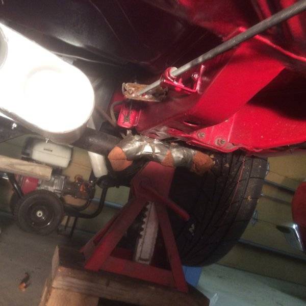

You probably have a bracket on driver's side frame rail for 66 and later e brake. Bottom and top pic cable goes to bracket on trans cross member. Used a connecting nut and a threaded to get it to back of car. The coupler turned side ways in pic but fixed it. With a little more thought it could be better.
