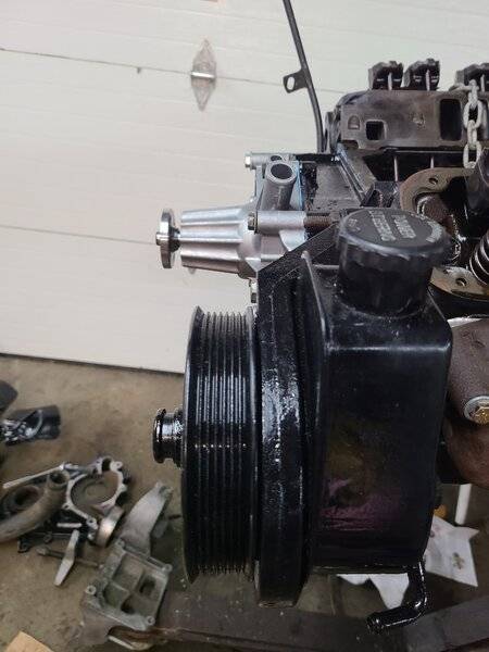

Long story longer, I replaced the '94 timing chain cover with a '70's timing cover with the hole for a mechanical fuel pump. All good...until that made a 70's water pump necessary. Got the water pump set on there and quickly saw that the nose of the pump extended WAY too far forward to get the pulley to line up. The difference in pulley line up is +/- 2-1/2" or so.
I had intended to use the serpentine belt and pulleys, but it's beginning to look like a giant PITA. Looks like there is also going to be an issue with mounting the alternator too.
My questions are-
1. I'm sure others have done this before. How did you resolve the belt line up issue? OR, is there a water pump with a shorter nose?
2. Would it be a better idea to dump the serpentine belt idea, and go to a regular v-belt setup?

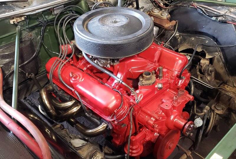

I magnum swapped my 69 Dodge wagon.
Mechanical fuel pump. Points ignition. .............

One thing I did find out is that you can't use an LA water pump on a magnum timing cover. Impeller depth is deeper on the LA pump, so the pump ends up about 1/2" short of surfaces mating with the magnum timing cover. The other thing that is irritating is the LA pump has the heater core inlet/outlet on top, just right of center...right where the magnum one piece casting for A/C and alternator mount exist. You could probably do some creative carving and make it work, but I opted to go with the v-belt pulleys and mounting hardware because I found some cheap parts on Ebay.
All told, I had to secure LA power steering pump and mount, alternator and mount, and correct water pump pulley. Hope it's worth it!
