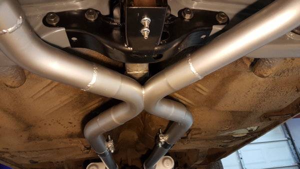

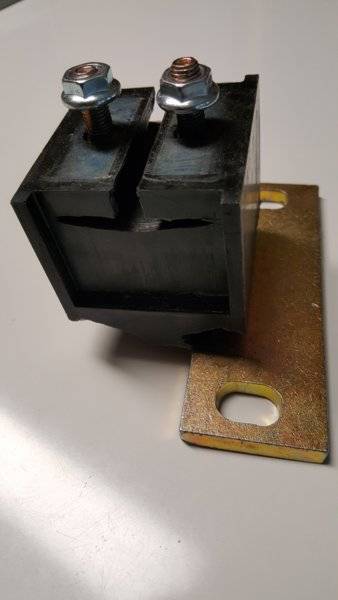

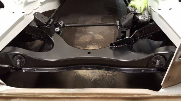

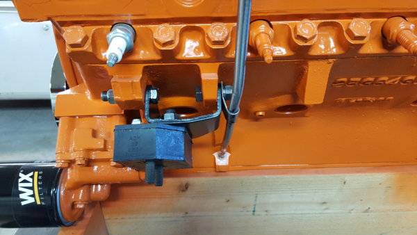

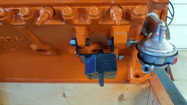

Here's what I have on my '62 Dodge 440ci and auto.
Motor mounts right and left...
Trans mount...
https://www.classicindustries.com/product/all-years/dodge/coronet/parts/mb2668.html
Pretty much same thing on my 64 Ply. With a 'later' 727, mine a 67, also had to modify the trans crossmember mount location...moved it toward the rear by 1/2".
That's using a stock 62-64 BB K-member.
