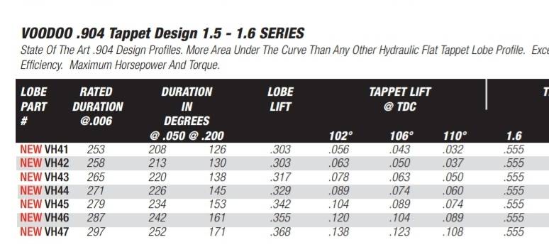

Any of the cams listed in post #2 would work with the existing engine, except for needing new valve springs and timing gear.
The Voodoo cams use a 3-bolt timing gear. You can get the hughes cam with the 3 bolt setup also.

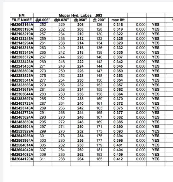

The hughes cams are made for them by Howards as far as I know. This is the lobe list with more detail then hughes offers if you want to compare. The voodoo is assymetric on the intake. Howards grinds are likely more symmetric.

Nothing slow about a voodoo its a agressive grind. It's how they get more area under the curve open the valve fast and shut it fast. The voodoo was designed by the late Harold Brookshire the founder of ultradyne. He was one of the pioneers of assymetrical cam design in the 70s. My favorite Brookshire quote..was when someone compared his ultradyne cam to a comp cam spec, He replied "all 5'2" 110lb blonds, did look the same".

This is the cam that i like the most so far. I figured if i move power band much higher I’ll begin to lose my low end torque. Unless im misunderstanding something.
[1] There is no way of telling if a cam lobe is symmetric or not by looking at a catalog description.
[2] Asymmetric lobes are nothing new. My 1974 Isky catalog has a section on them.
[3] I would think all cams from the major cam companies today would be asymmetrical.
Yes. Bullet cams is one of the few that lists there symmetric profiles. There are quite a few symmetric cams out there yet such as the summit cams. We typically measure out the profiles before we installed them to take a closer look.
To be clear...Hughes are assymetric. Designers just have differing opinions as to where the assymetry belong.

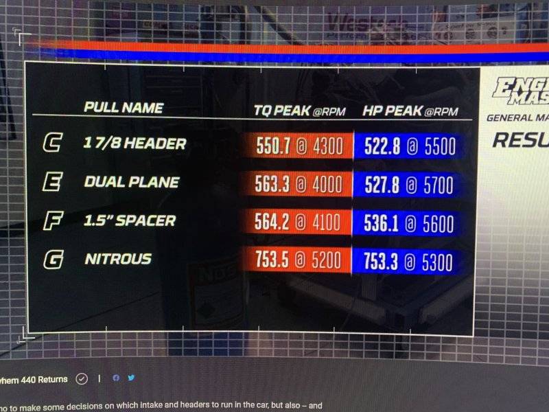

Engine Masters|S6 E104
•General Mayhem 440 Returns
440 Source Stealth heads,
Schneider cams Hydraulic roller .244 intake/exhaust Dur @50, .555 lift, 110 degree lobe separation
Mopar P5153525 dual plane intake,
TTI 1 7/8 primary tube headers,
JESRP pistons with 10.25:1 compression,
Rods are H beam with .990" pin
Forged stock crank,
Stock rockers,
Holley 830cfm HP Carb,
CVR 1.5" spacer
Results:
1/7/8 headers 550.7lbs Torque, 522.8HP
Dual Plane intake 563.3lbs Torque, 527.8HP
1.5" Spacer 564.2lbs Torque, 536.1HP
Nitrous .60 753.5lbs Torque, 753.3HP with 116 octane, 30 degrees of timing, 1" spacer, and a .25" nitrous spacer
