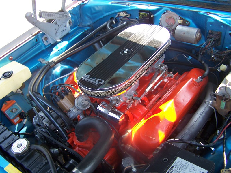

POR-15 makes a very nice very smooth very forgiving Tourquoise with excellent heat resistance and a nice semi gloss finish
The same goes for the Orange (especially with an extra carb...:yes:
