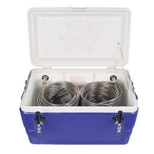

A liquid conductor around spring tubes that hold internally the AC freeyon that works off like a usual AC compressor. Will this work?
i know more metal weight probably in the water jackets but could this still work?
I’m pretty sure you need a way to transfer the heat outside the engine but I don’t know how yet without the usual thought of circulation.
A water pump that sucks the water out of the spring tunnels and places new water in! I forgot it! I think I got it. But you have to have a continuous AC freeyon that transfer the heat to the water so the water can be sucked out and then another water pump places new water in! I got it!

So like a jockey box, but for your engine!:drinks::drinks::drinks:
