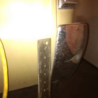

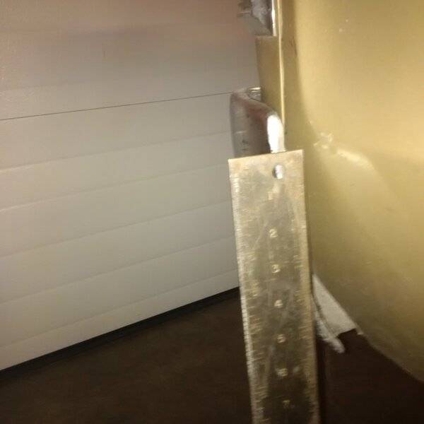

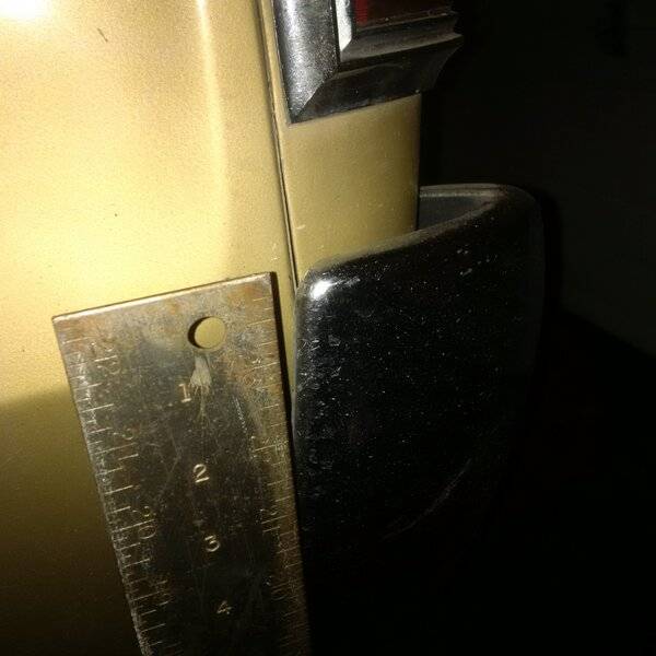

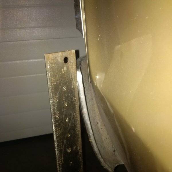

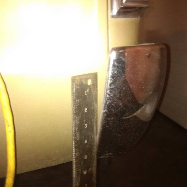

Since the contact at ESPO had no idea where stock began or ended I just laid a steel square against the center of each side's wheel opening trim and also at the top front edge of each bumper end. I don't think my car's had work on either element in its 54 or so years on the Earth, but it looks straight. There's probably a better place to make those measurements on the frame, I'd guess a longitudinal, but this works for my A-B check. I found the passenger side to start off maybe 1/2" lower than the driver's side, this may in part be due to a heavy battery in the trunk on that side for 15 or 16 years.
I'd installed two of the same S/S Spring, the ...456 part # for 3400lb cars, just because I was curious at the time and wondered if the factory bias of the original sets might cause the car to sit crooked or drive that way, and I drive the car more on the street than race it. Didn't seem to hurt, the car only runs in a 12.00/7.50 second class, best of 11.5 in the 1/4.
The car now sits level, as measured at the bumper top edges, the pass side came up around 2" and the driver's side 1.5". I can go through old pictures of the car at rest to see where the wheel well trim crosses the wheel and see that difference, better are the pictures by our track photographers of the car approaching the staging lights. I'll try to post links to some of those images, but something else they showed me was the car used to raise the rear on launch and now it squats as the leaves let the axle wind up. Fortunately it doesn't seem to affect the car's run, I have very similar reaction, 60' and 1/8th mile times. Have an adjustable pinion snubber to try next, it never mattered with the S/S springs that I could tell probably because those springs did what they were designed for with my car.
Attached images, if this works, show each side's before and after shots.
IMG_20210824_Pass side before.jpg IMG_20210824_Pass side after.jpg IMG_20210824_Driver side before.jpg IMG_20210824_Driver side after.jpg

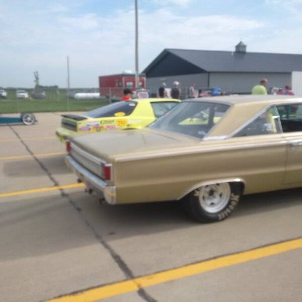

Track photos, hope I am not breaking any rules by linking to their images as we've got some pretty good guys who sell their photos to racers and other interested parties. The races were on the 21st and 28th of August, I swapped springs between those dates. I'll try for a shot of the car staged and then launching on the 21st, then in the burnout box and launching on the 28th. I stage it at 2800rpm on a 9.5" Dynamic converter, could take it 1000rpm higher, the car doesn't seem to rise up at the lower rpm level anyhow.

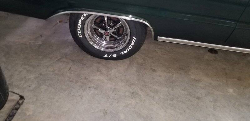

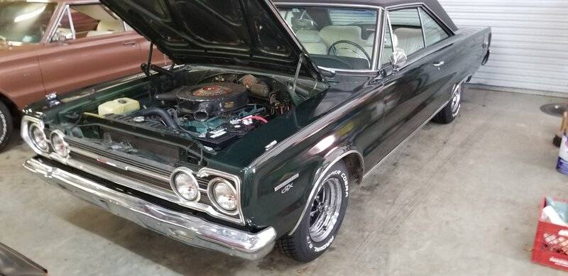

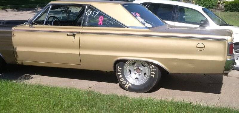

Stock ride height on a 67? I don't have a measurement, but my new car in 1967 sat where looking at it from the side, the top of the rear wheel well was even with the top of the rim.
This angle of the picture is looking down some, but if I had taken it directly from the side you could put a straight edge between the wheel well and the top of the rim and it would be level. Ofcourse we all have our ideas on stance and I like for the front to sit lower than the rear by 1/2" measured at the rockers to the ground.
I do not have a FB account on the laptop I use for this site and am able to see the links, hopefully it works for others.
My purpose with this posting is to show that my car wasn't really raised much if any over its height with the 318 springs the car came to me with at 45k miles (I don't think it was 145k) when I added S/S, and that the arch of the ESPO XHD +1" springs did indeed raise the car above where it sat with S/S 3400lb springs after 15 years or so.
I've got 15" rims on the rear of the car, for reference had looked at the relationship of the rim against the wheelwell trim, or where a continuation of the lower body line ran in relationship to the center of the wheel since 14" or 15" rims wouldn't affect that.

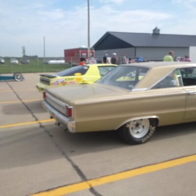

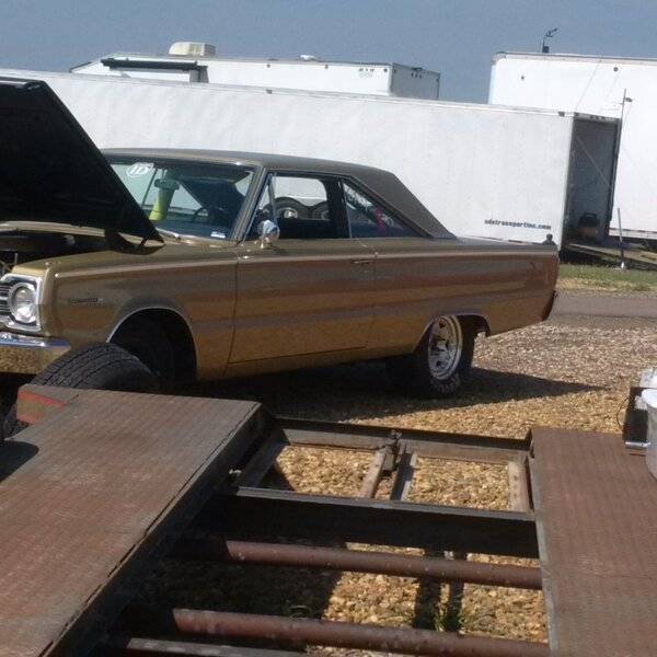

Same slicks on the car, here's a shot of the car in the staging lanes with S/S springs and a couple with the ESPO springs right after installation.
