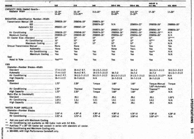

Here's what Chrysler did for pulley ratios. That said, I use the recommended ratio, but a Flowkooler w/p. No cavitation issues.
Here's what Chrysler did for pulley ratios. That said, I use the recommended ratio, but a Flowkooler w/p. No cavitation issues.View attachment 1313918
so what pulley diameter corresponds to your recommended ratio?

Sounds like I may be fine with the higher flowing flowkooler pump in conjunction with the smaller 5" and change water pump pulley. If I have any problems I can always swap the 6 fin pump I got from Mancini back in.
