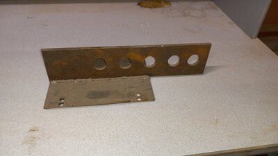

I used the eye bracket that bolts to the front and rear of the engine block. I had read somewhere not to use the plate bolted to the intake manifold so I bought two brackets and used those with my levelor bar.

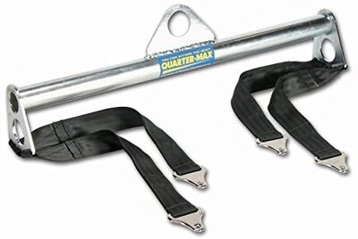

I have both a 4150 and a 4500 lifting plates. I just don't trust them on aluminum intakes. Usually, they don't work for me anyway since I am a multicarb freak. Most of my cars are cross rams, sixpacks, or dual four Hemi's. I know tough problems to have... lol. Most of the time I use one of these engine slings.
Another vote for engine leveling sling.
makes it so much easier to lift/drop motor and tranny in, almost a one man job. After using it, realized I should have got one sooner.
Can u post the part number of this engine sling? And where can I buy it? Thanks. Kim
