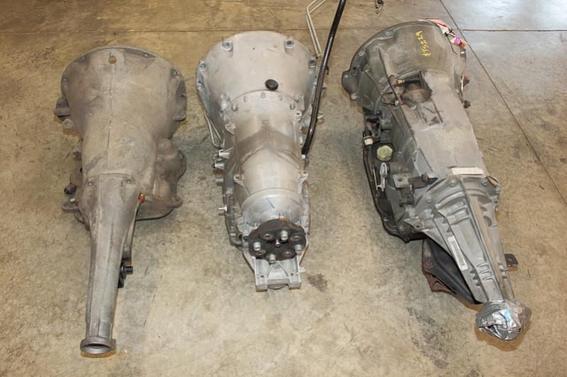

I don't know what a 545 and NAG1 is, other than Transmissions. I was told the Transmission I have came out of a truck, and the Engine out of a 2006 300, or Charger. So, is this a NAG1 or 545?
Which one does it look like?
Donny, you have the 545rfe transmission.
Mine looks like the one on the right, the left is a 727 and the middle is the one in the Challenger/Charger, right?
Middle is a NAG1.

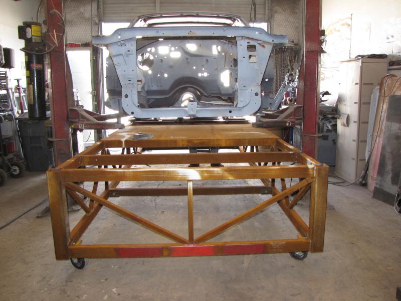

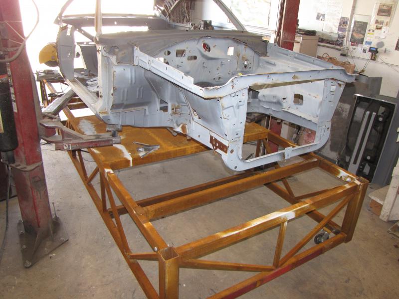

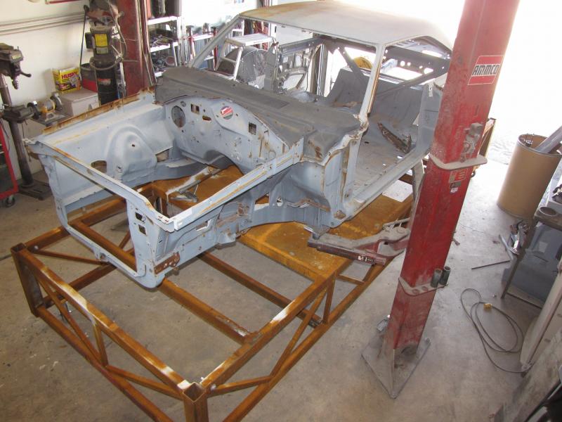

I look fwd to fabricating the Satellite up to hold this Engine/Transmission. I'll be removing the Radiator Upper and Lower Cross member and slide the entire assembly 'back' into the engine bay while it's on the Chassis Table.
I did the same, but I don't have a frame table so yours should be really easy.
Don't say that out loud.......we'd miss ya!
So how long before the surgery starts?
