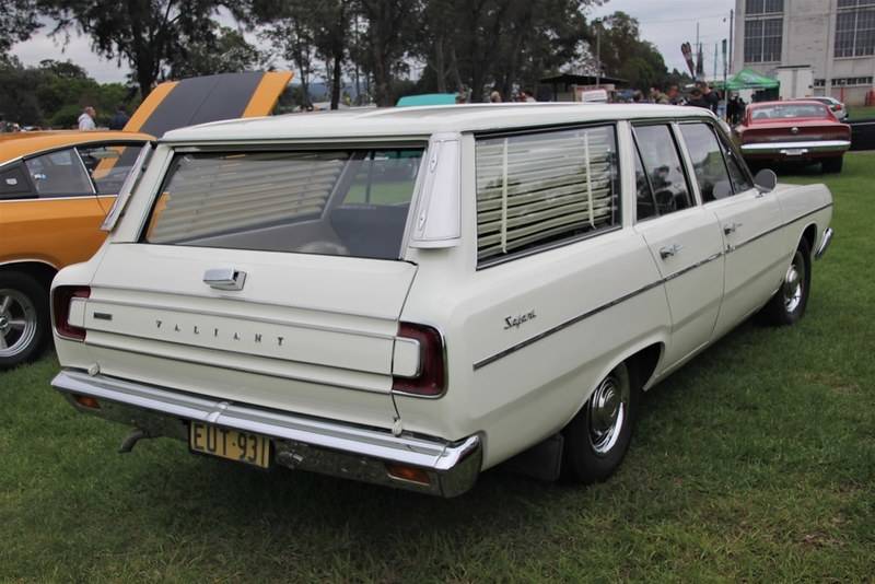

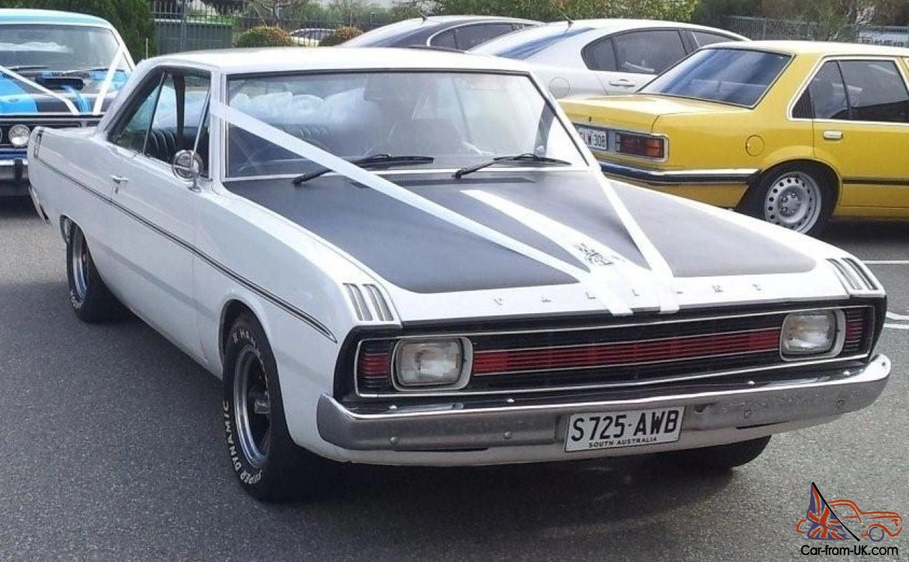

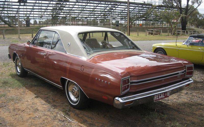

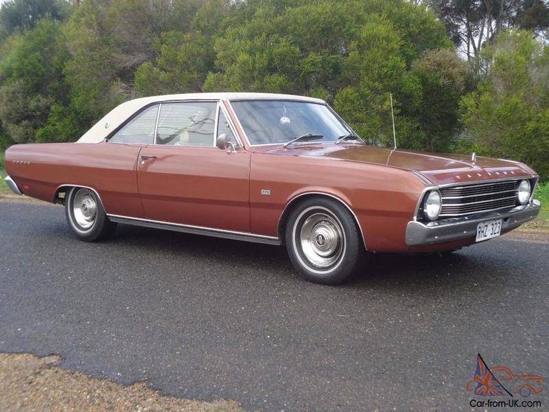

The Chrysler Valiant and Charger models came out with only small block V8 engines - plus the slant 6. ...225 & 265 /6, plus the 318, 340 & 360 engines later on. Challenges were plenty to cram all the parts inside, as the body and engine bay was smaller.Hmmm, I suspect that the Aussie cars were a completely different design. How many big (or smallblock) Aussie Mopars have you seen ??? Ever seen an Aussie Road Runner ?!?! I think most of the cars would have been built using the Aussie inline six (hemi ??) and would have had a different steering box, etc.. There should be a bunch from that era still running around - it ain't like they rusted from snow and salt on the roads !!

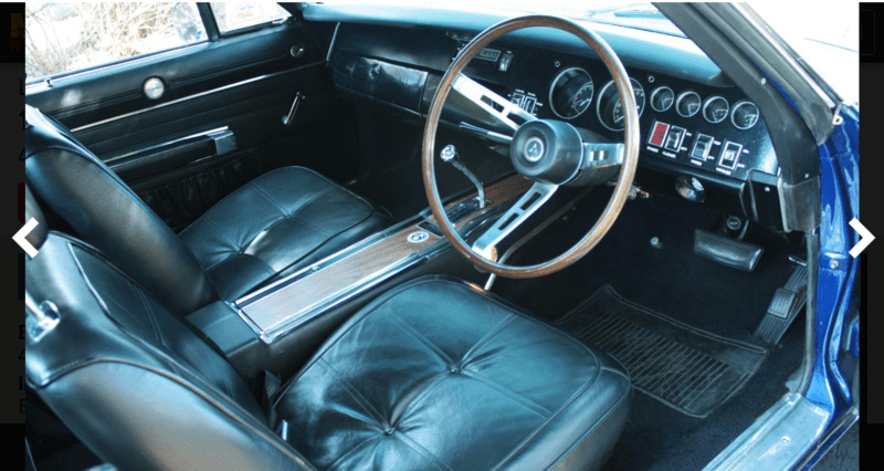

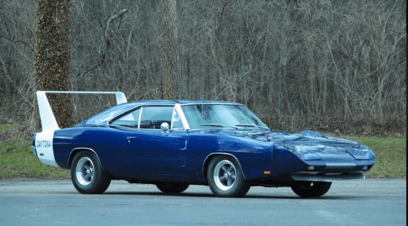

Built on April 27, 1969 and sold new at Independence Dodge in Independence, Missouri, it was shipped to Australia in 1973. There it was converted to Australian specifications, which in addition to right-hand drive, included adding front turn signals to the underside of the nose cone and integrating amber turn signal lenses into the taillights.
NOT a factory built RHD car....and no mention of the headlights being changed...which is the more important detail that our localnazisInspectors look for upon importation.![]()
Converted in Australia to RHD. Not a factory car.View attachment 918710 , somebody built it.

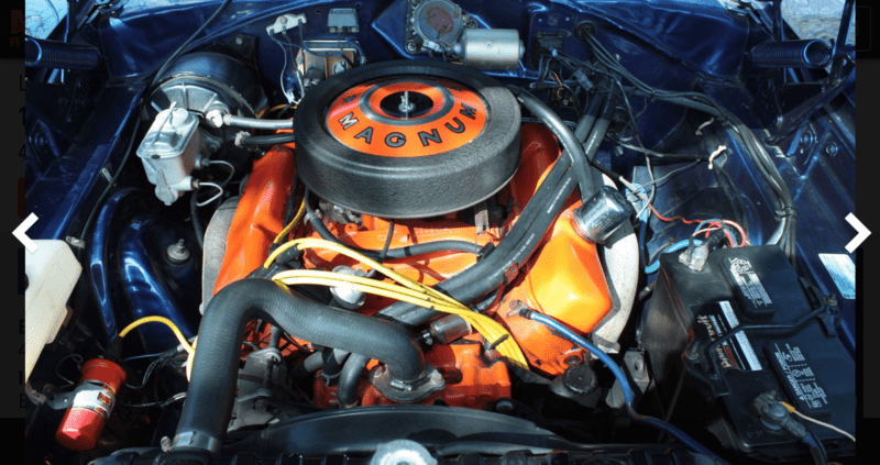

It's done with the location of the mount 'stands' that are welded to the K frame.....I know the offset is certainly for steering clearance, and that offset is carried right down the car. The trans tunnel is even offset approximately 1 1/2". I was just wondering how the engine position was obtained. It's difficult to tell with the engine still in the car. I wasn't sure if that 1 1/2" was in the mounts themselves, or where they attach. Thanks
