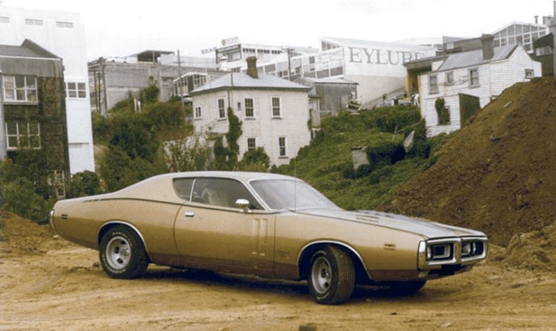

Not only that, Chrysler USA did not make many RHD cars at all. I did find many years ago a '1 of 6' RHD factory variant of a '71 Dodge Charger out of the LA Plant....440 6-pack 4 speed car....all the fruit. It was totalled in a high-speed moment of idiocy here ....now it's gone to the weeds.
The story I heard was that the plant suffered an earthquake while producing that RHD run of cars, and it was taken as a bad omen....so no more were produced. Anyone care to verify or deny that story. It was one of only six made RHD. I know a guy who owned that car a few years before it was wrecked here.

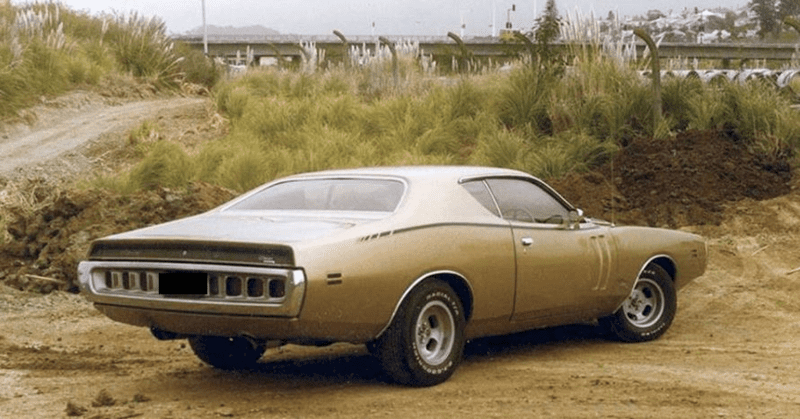

Here are the pictures I found a few years ago of that Charger here - RHD from the factory...
The steering wheel is quite visible here.
