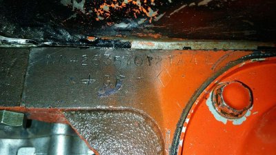

Anyone out there have the magic decoder for this 71 426 Hemi engine on the numbers on the oil pan rail?
IIRC the diamond means oversize tappets.
just going by memory though...
here is what I know thus far - correct me if I am wrong
NM4263570121442
NM/426/3570/121442
I think NM should of been MN and was stamped wrong - MN=Maryville Plant
426 = easy, 426
3570 = 10000 day calendar for May 7th 1971
Diamond = oversized tappets
any idea what the 121442 is?
no - the Vin is RM23R1G219753
according to the link you sent 121442 is the serial number - A sequential number for each days
production beginning with 0001
