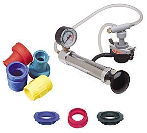

If you have concerns about a head gasket you can buy a radiator pressure tester or even get a loaner from a local parts house...
