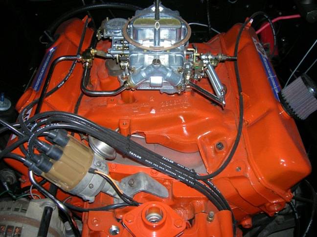

To my eye, it looks more like race orange.
