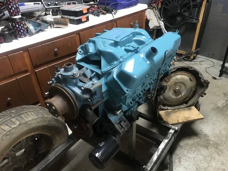

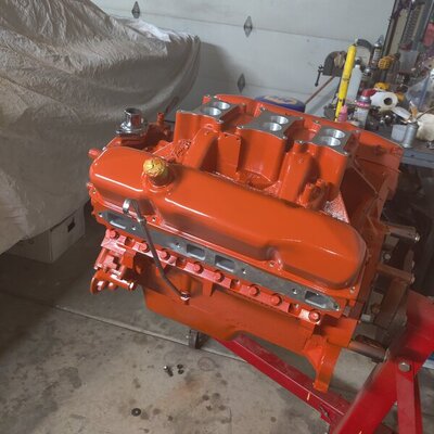

SP120 and 126 both are shown in these 2 engines I did.
I have never had any issues with VHT or Dupicolor engine enamels on my engines.
