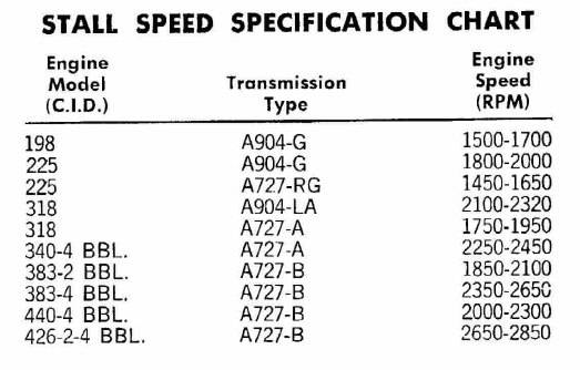

Do you know your true measured compression ratio? If not let's at least get an idea by measuring how far the piston is in the hole. Have the heads been milled heavy, just touched up, or nothing at all? If they are untouched I'd use 89cc as a close guess. If it's 9-1/9.5-1 I'd put it in at 110, maybe even 108 if it's below 9-1. A stock 10 3/4 converter (340, 383 HP, etc) won't be to bad. A stock 11 3/4 won't be as good.

that cam doesn't need a looser than stock converter (10 3/4 4bbl converter). doesn't need 4.10 gears either. would like something bigger than a 600 edelbrock.

Use the stock key position with initial advance 15-16 degrees. A 2400 convertor has quite a bit of slippage and you can easily go to 32 - 3400 with no detriment. Actually you'll not only get better performance in the higher range, you'll also get better mileage. It is adviseable to use a separate tranny cooler, not just the rad loop.

Also, here is a stall speed chart from the 1970 shop manual that was posted by Photon440 in another thread:
