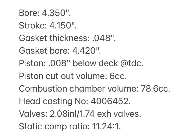

I had my 1978 440 engine rebuilt here in the UK in 2019.
Some concerns have been raised in a previous thread regarding the spec.
I’d really appreciate further input as to whether my chosen engineers have made errors in the build. Please see the photos for details.
I’m new to the whole “forums” scene so thanks in advance.
Very much appreciated.

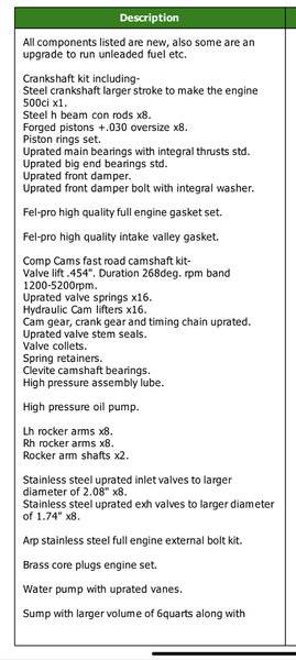

First off your camshaft specs are wrong
You mentioned - It’s a Comp Cams Kit K21-227-4
It was pointed out as the Comp XE275 HL - Those specs are
275/287 - .525 .525
Did they degree the cam ?
Then the bigger question was the static compression and your head cc
Are they in fact 78cc or 88cc

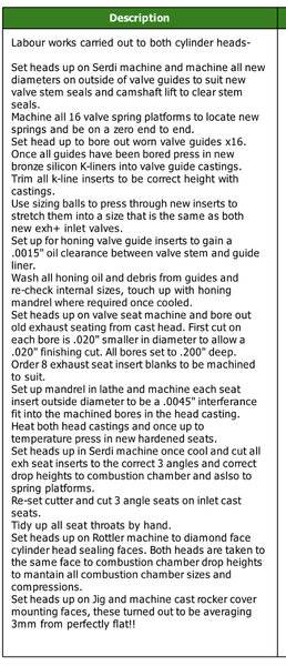

Where in fact the heads milled ? That’s the big question
You need to ask the machine shop if the heads where in fact just resurfaced or cut and milled
Because if they where cut and milled , that might explain the pushrod / rocker arm issue

Assuming everything there is correct and measured you’ve got way too much compression for anything other than race gas. Should be a torque monster with that many cubic inches and that fairly ordinary cam.
With the small cam and iron cylinder heads and your compression ratio I believe you have created the perfect conditions for detonation. I see you want to run unleaded fuel. Can you get 100 octane unleaded in Scotland?

Like Bee1971 suggests, there are questions regarding the info that has been supplied. Therefore we cannot speak with confidance as to the appropriateness of the build. I think you need to first verify the info that you've posted by doing a deeper dive on all of the documents/information supplied from the builder, doubling back with your builder, and/or pulling the cylinder heads off the motor.
Was there a bill of materials? Was there an invoice/bill? Where did your first list of specs (bore, stroke, gasket thickness....) come from? Was that from the builder himself, or info that has been transposed from another source?
- The description states that the heads were milled on a Rottler to even the chambers, but does not state how much.
- 0.048 gasket thickness seems like an uncommon thickness, Is there a supplier or part number?
- Who is the pistion, rod, crank source?
Now that I've reflected on what I've typed, I 've concluded that you need to pull the heads.

Thanks fir this. All the information in the photos came directly from the engine builder. The two photos with green bars showing are cropped from the actual invoices.

Without knowing how the conversation went about what your hopes and goals were for the engine, it’s tough to say if there were “mistakes” made with the combo or not.
I would think the first step in getting things rectified would be to bring up your misgivings to the shop that built it, and see what they have to say.
My opinion is the CR is too high for what it sounds like the intended use is..... so, who ever gave the 11:1+CR the green light is where I’d be pointing the finger.
Frankly, if the thing had 9.5:1, it would be fine........ other than the failing rockers.
