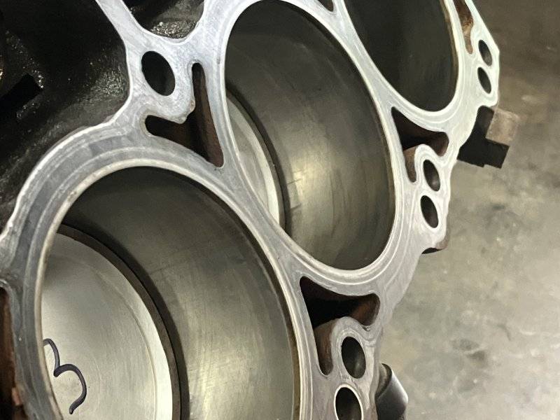

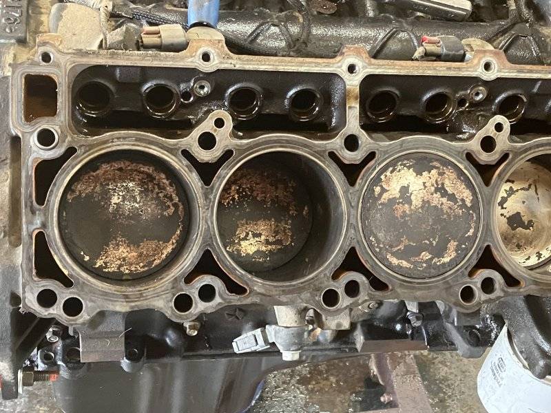

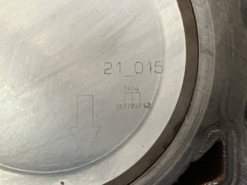

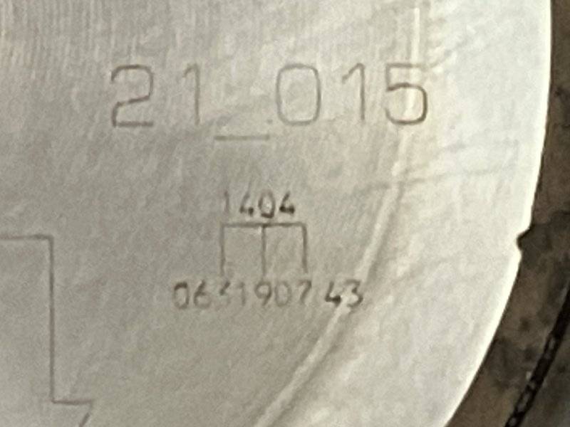

The Bottom end has been rebuilt. It looks like they went .015 over with Mahle pistons.
View attachment 1459738View attachment 1459739

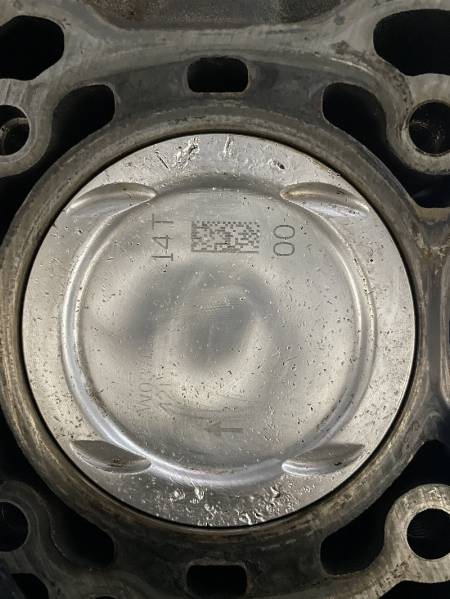

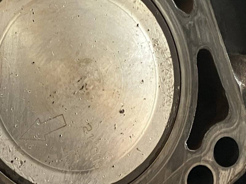

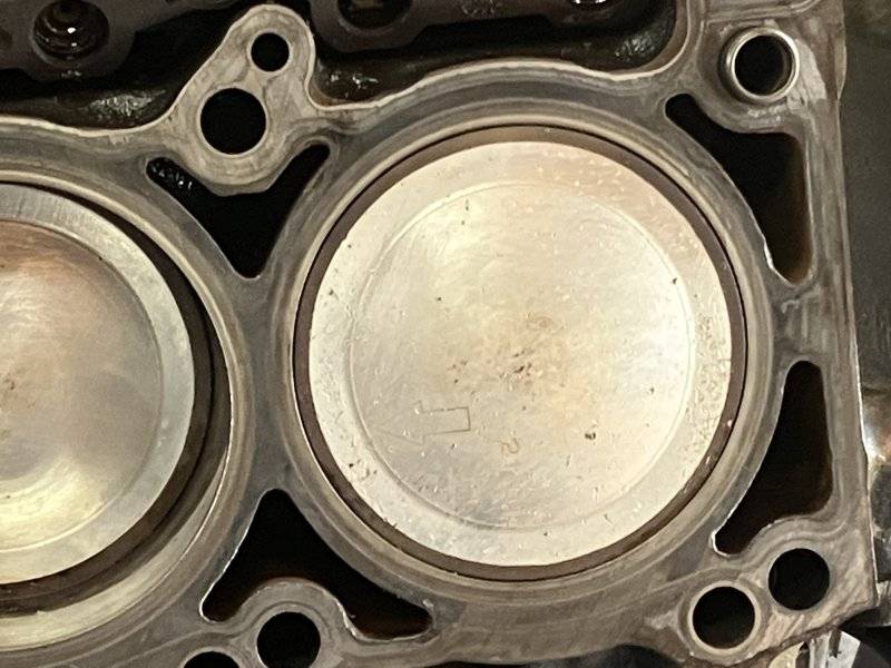

Cylinder #7 has some damage.
I’m curious about this. I wonder if this engine had a valve seat go on cylinder 7…Maybe these heads aren’t original either.
There is no ridge on any cylinder. The pick marks on #7 piston shouldn’t pose a problem. That cylinder had both spark plugs recessed/not screwed in all the way. Could this be detonation due to improper combustion? All the other pistons and cylinders look great.
I've never heard of it on a hemi, but maybe they had a spark plug issue like the ford's and some **** fell in there with a bad spark plug retrieval

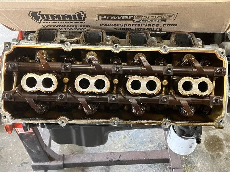

Everything is coming apart easily so far.
There are a few broken exhaust manifold studs as expected.

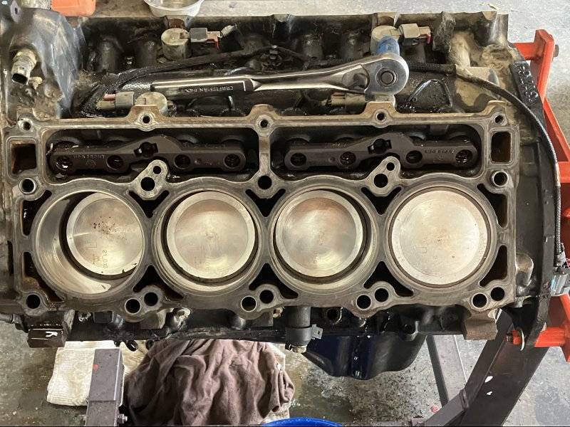

View attachment 1459713View attachment 1459714

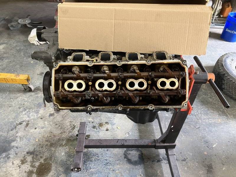

I’ve heard that the heads have to be off to get to the lifters. I see why now.

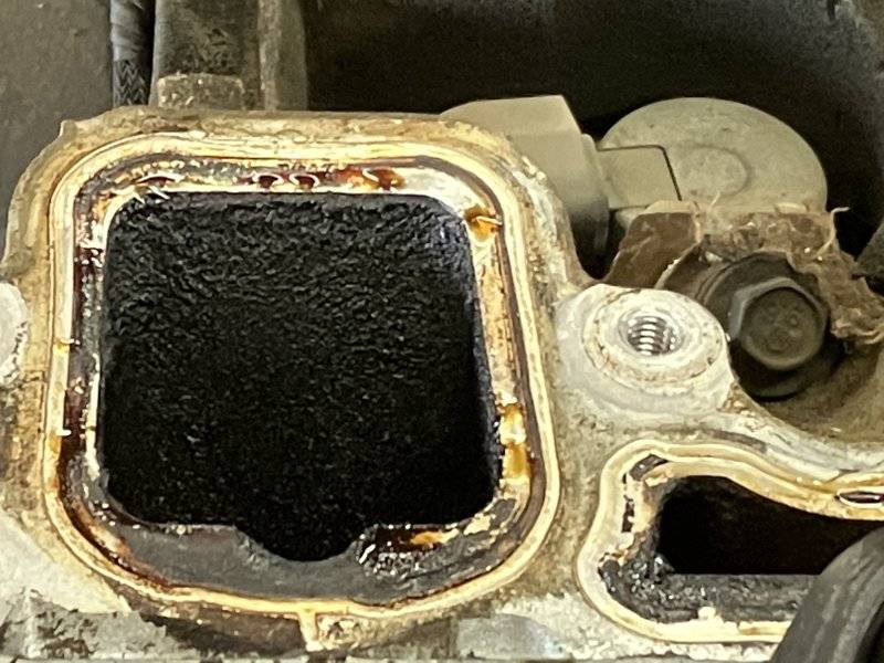

Lots of carbon on the pistons for a “83,000” mile engine.

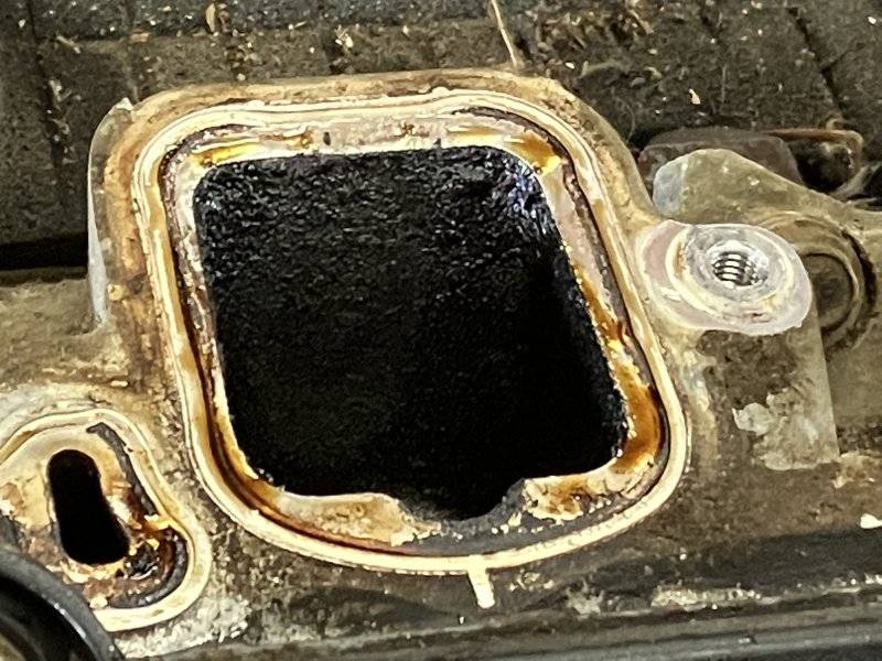

Late model stuff can have issues with poor crankcase ventilation control which leads to oil contamination. Good idea to incorporate a catch can into the system. This company makes an excellent one. There are others of course too.

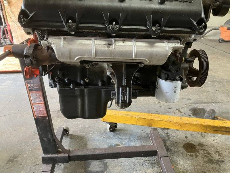

I loaded the short block and the heads back into the truck. Tomorrow I'm going to see my machinist.
It is a given that the heads need attention. I'll let him determine if the short block can be run as is.
All the lifters looked great and I kept them in order but I'm going to replace them. I'll need to replace one of the MDS solenoids since I damaged it trying to remove it.
I have not pulled the cam. If the lifters look good, the cam must be fine too, right?
Lots of variables here. Maybe I'll pull the front cover to regasket it. If I do that, I could replace the timing chain and pull the cam to inspect it.

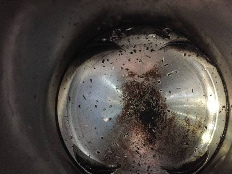

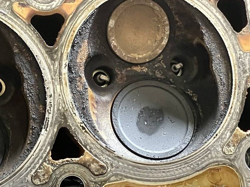

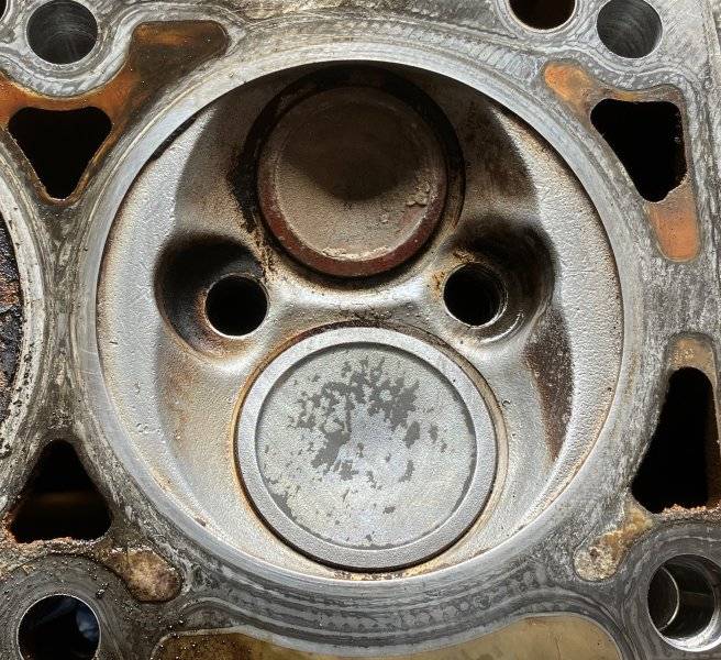

When I was dealing with detonation issues with my 440/493 some 10 years or so ago, I was told that detonation resulted in marks on the piston that looked as if the pistons were jabbed with an ice pick.

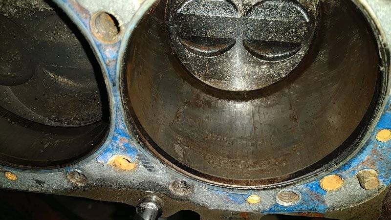

With the big block, even though I heard what I thought was detonation, there was no evidence of it in the combustion chambers or on the tops of the pistons. With this engine, the # 7 combustion chamber was carboned up but seemed to look okay:

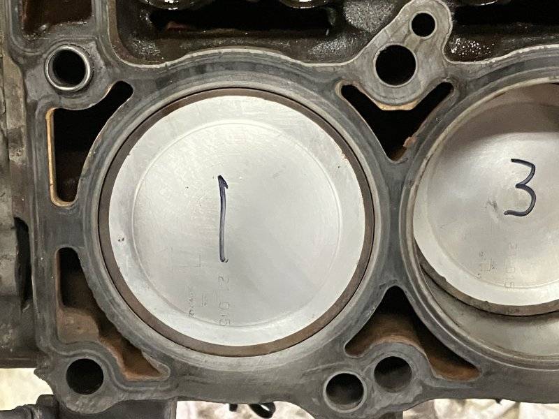

The spark plugs look recessed but that is just because they aren't screwed in all the way. It was like this when I got it. The chamber cleaned up okay but does have some small marks in it.
They are not dished...The pictures in post #107 were pulled from the internet.
These pistons have a slight dome.

I brought the heads and the short block to the machinist. He says that unless they are abused, most late model engines run a long time. He liked how the cylinders walls looked but plans to take a micrometer to them to see if the engine has been bored over. That weird 21_015 number has to mean something.
He thought the heads looked fine at first glance but will disassemble and check the valve guides and report back.
