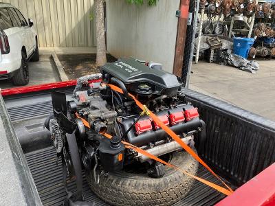

Engine bought last week. $2250 for a 2007 5.7 with approximately 100,000 miles.

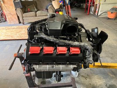

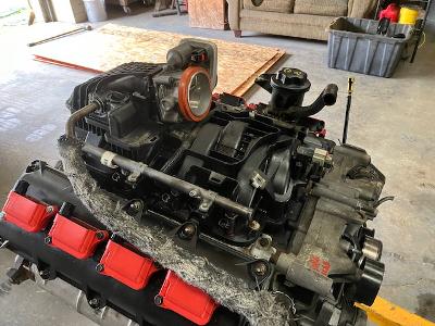

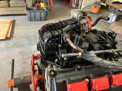

Air box removed, next comes the intake.

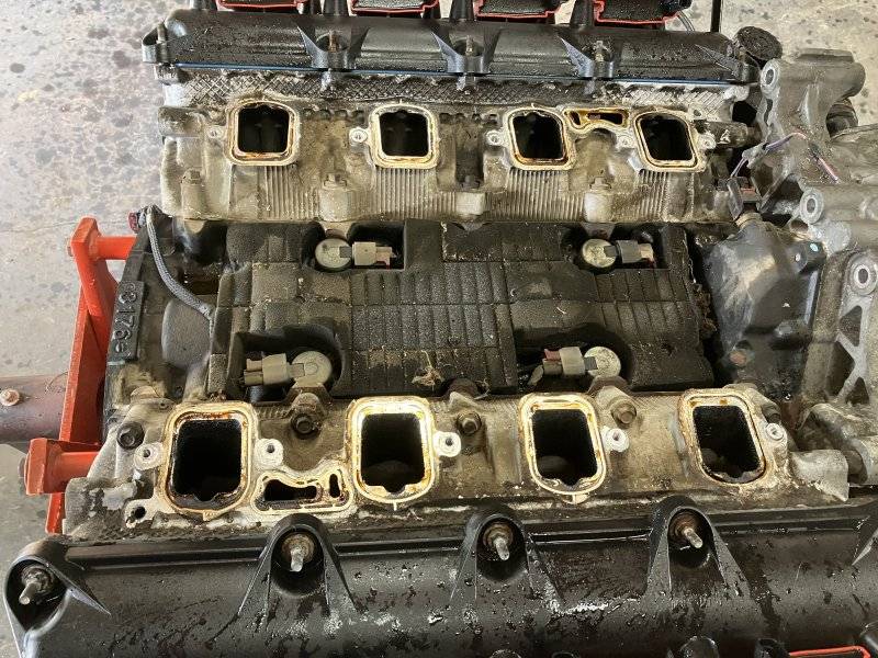

Intake is off.

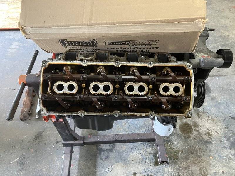

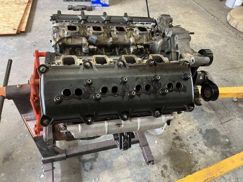

Valve covers off.

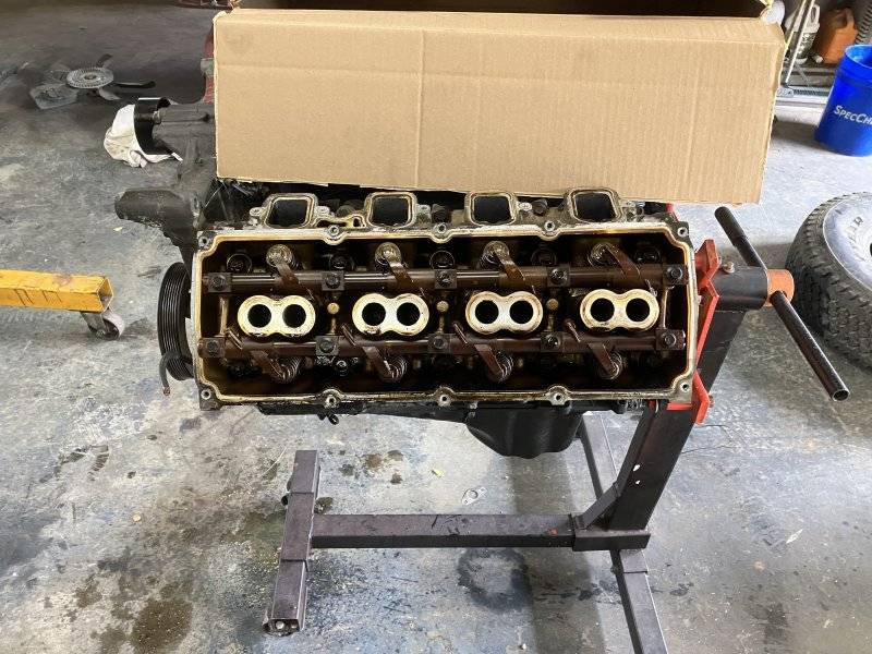

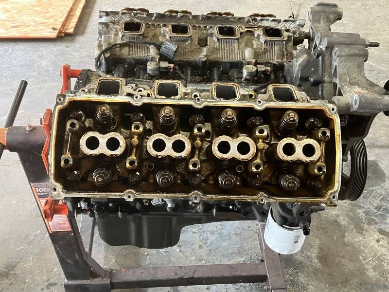

Rocker arms and pushrods come out, then the head bolts....

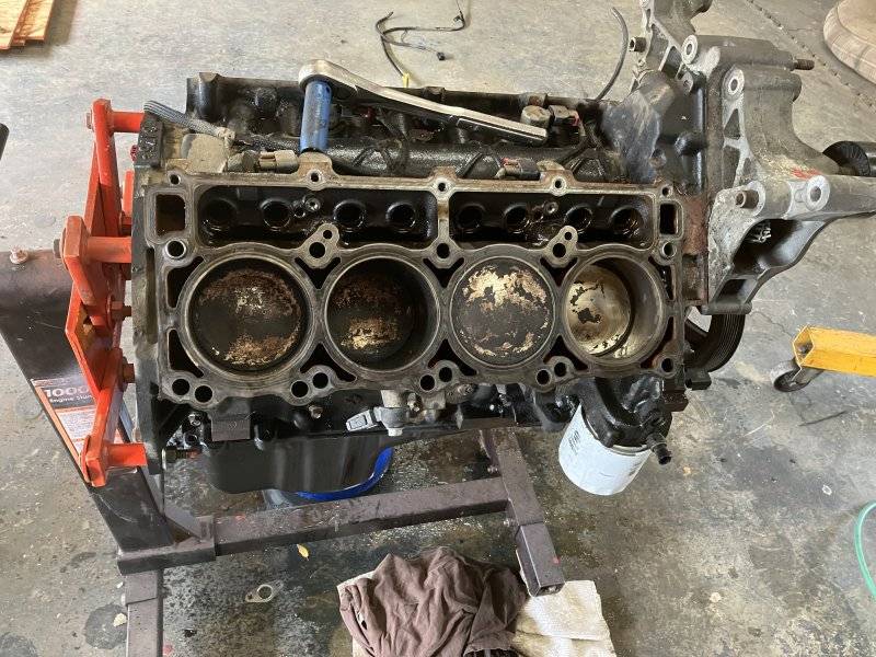

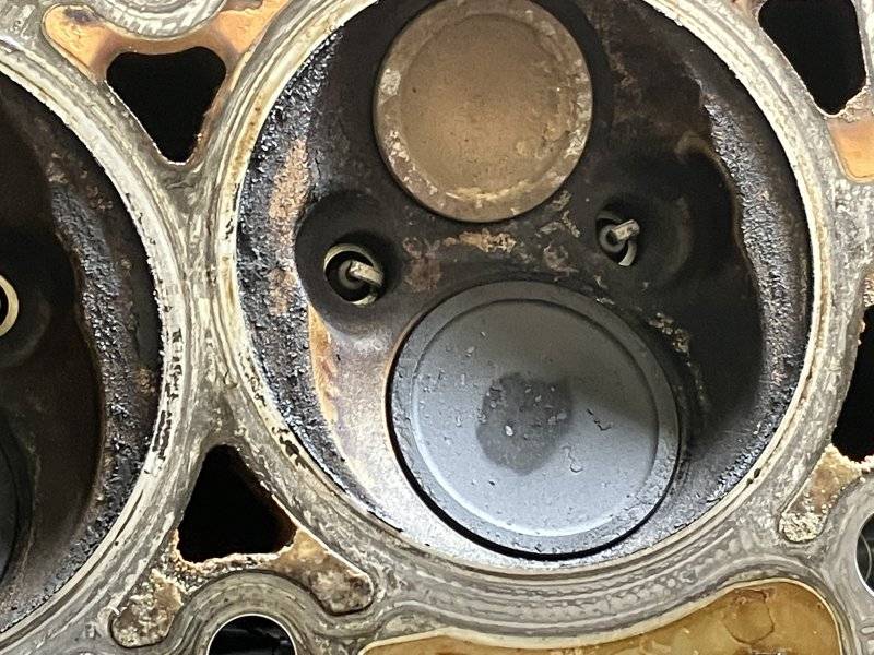

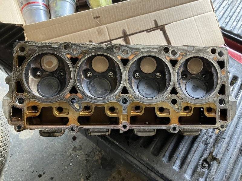

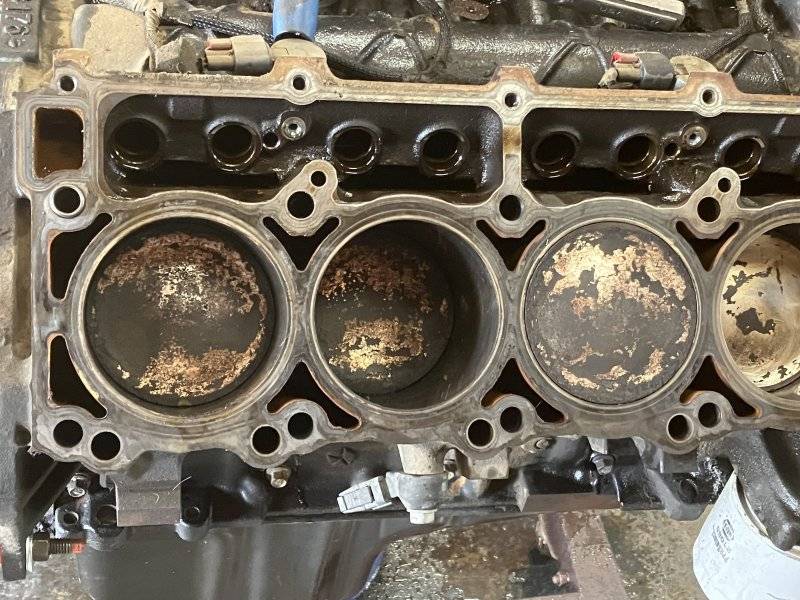

Heads off. Some carbon is visible on the pistons.
Combustion chambers look good. Tan color on the exhaust valves indicates proper burn.
I cleaned the tops of the pistons.
Some numbers are visible.

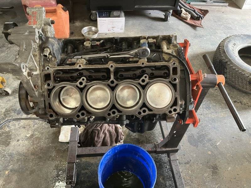

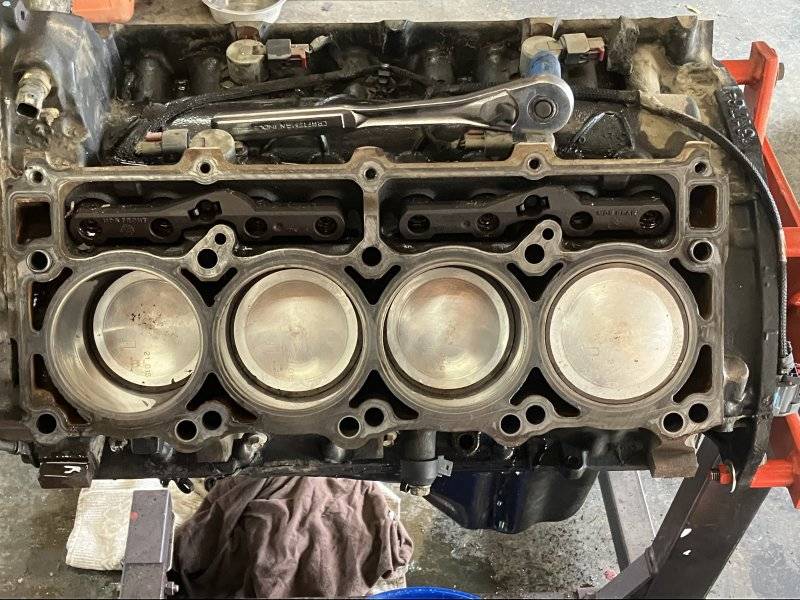

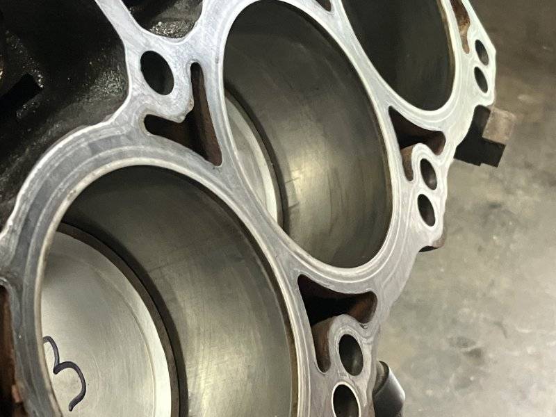

There is still some cross hatch in each cylinder.
The short block and heads are at the machine shop. I'm having the man go through the heads and stake the intake seats. I'm letting him determine if the short block is good enough to run as is without a teardown.

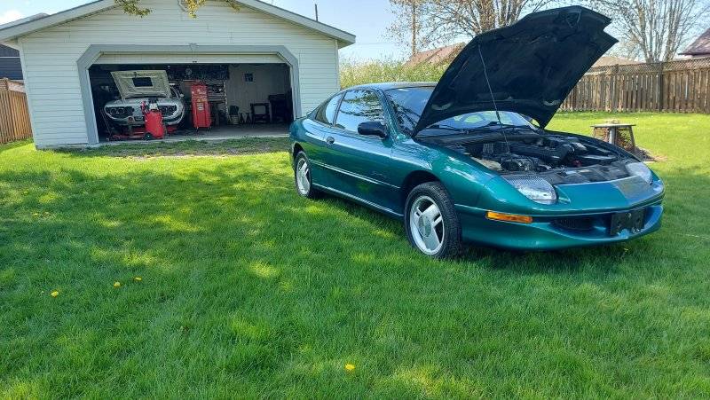

Kern, Im not anywhere near that many miles, but my 1996 Pontiac Sunfire is up there.
My wife bought this brand new in 1996. Its an SE not a GT (I have the rims tho).
2.2 engine - only time it was opened was for a head gasket change at the dealership back in 1998.

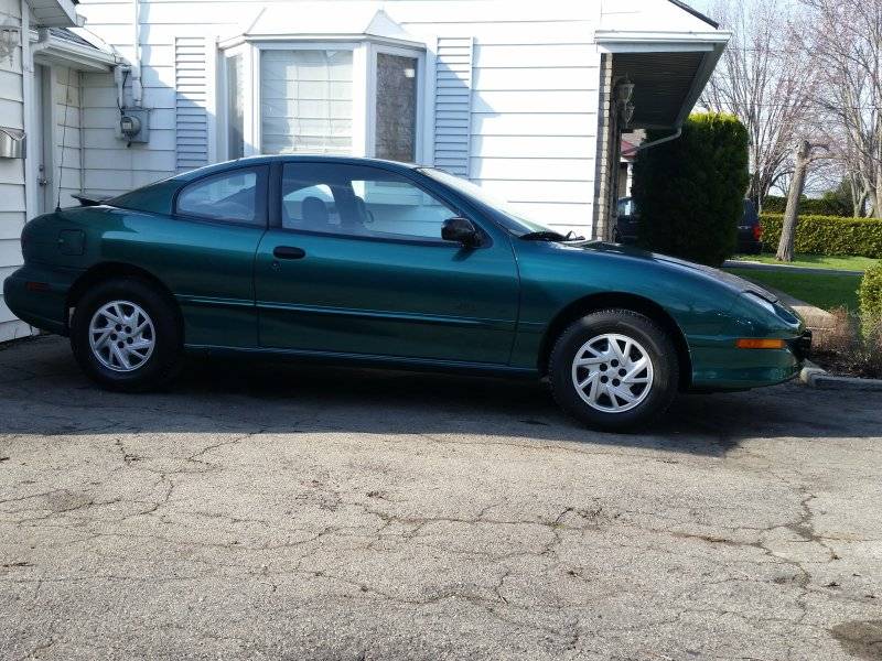

Here she is in her winter garb....14" snow tires and wheel covers.
Anyway, the engine has 415,000 kms which works out to 258,000 miles.
I only drive her in the winter.

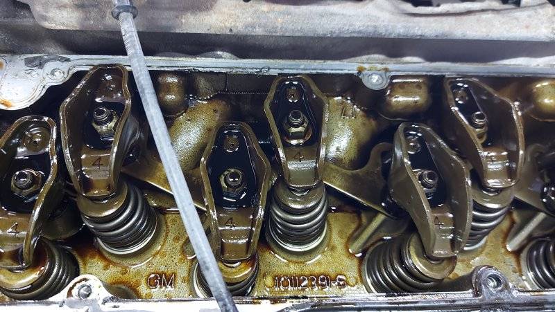

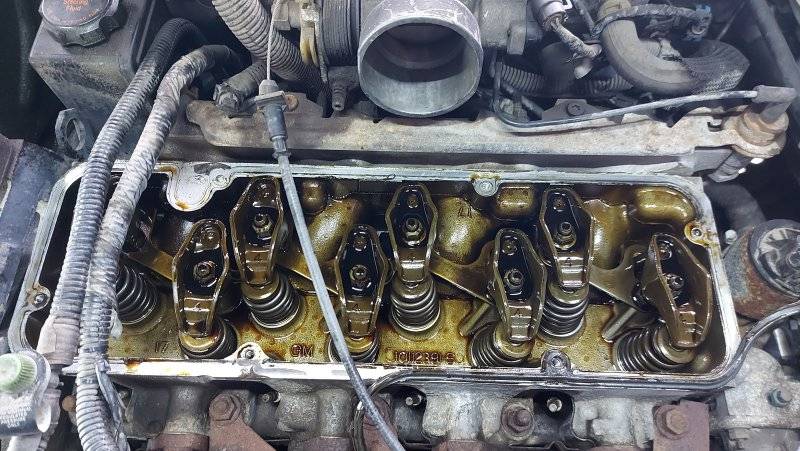

Here's a shot with the valve cover off.

Good news: The machinist is almost done. The bores in the block were all within 1/2 of a thousandth of taper from top to bottom so I won’t need to bore it and put in new pistons. SCORE!
I need to bring him the valve stem seals so he can button it all up.

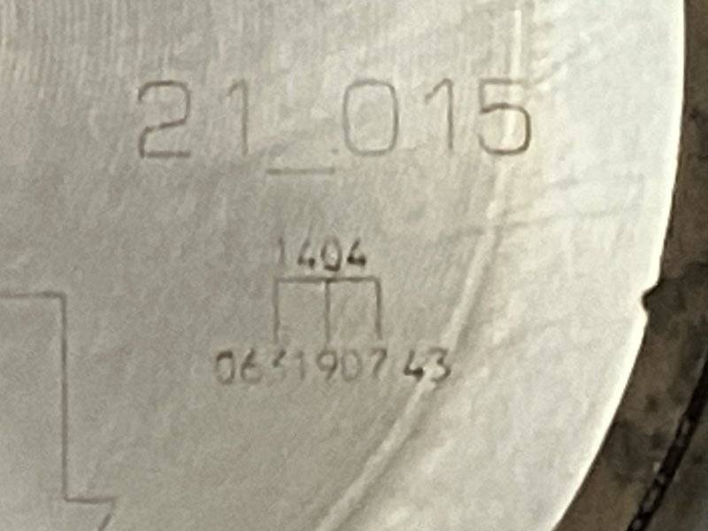

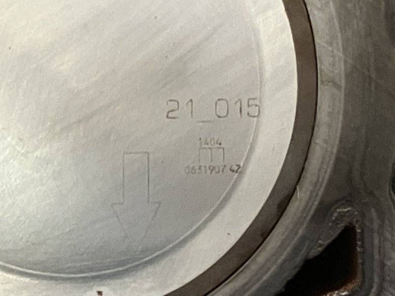

This engine will basically be a regasketed mill with staked intake seats. I’m going to call Mahle tomorrow to see if they know what these markings mean:
It seems to me that the .015 would mean a .015 overbore even though that seems like an odd number.
I'm sure your machinist has measured them & should know the current bore vs stock...
Being Mahle it could be metric 1.5mm is almost a perfect .060.. Actually .05905
