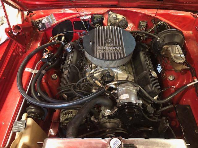

Hello, get ready for a strange problem that I am having over here....
My '70 Charger has had this problem for several months but because I've been making all sorts of other changes, I haven't been able to spend time on this one very annoying problem.
I will list the combination first:
440/493 with Edelbrock heads, EDelbrock RPM intake, MP electronic ignition, Demon 850 vacuum secondary carburetor. NGK spark plugs, MP 528 solid cam, 1.6 rocker arms, 2" TTI headers, 727 trans.
The symptoms: On the first start of any day, weather in the 60s to 80s, the engine is difficult to start and when it does, it runs as if it is only hitting on 3 or 4 cylinders. The Air/Fuel gauge shows it to be running way lean, past the limits of the gauge. It feels like a misfire/misfires.
As the engine warms up, it smooths out and runs like it should.
It is certainly unrelated but this problem happened some time after I started the A/C swap including the new water pump housing, radiator and shroud.
I suspected that the carburetor could be gunked up because in this past year, I've only started it and ran it here and I've only driven it in the back yard here. The 91 octane gas is old but does not smell varnished.
I had the carburetor rebuilt and added a replacement electric choke. The car runs the exact same as before. I cannot find any vacuum leaks anywhere.
When it was acting up before and today, I've tried swapping distributors, electronic ECUs, ballast resistors and coils. I have tried bypassing the ballast resistor by using a jumper wire to connect the wires. Each time I changed something with no improvement, I shut the car down and try something else. Of course, each time I start and run it, the engine gets a little warmer and on the way to running normal again.

You've added the choke but is it actually closing fully & does it have a pull-off, an unloader & stepped idle?
It is electric, is wired up but the butterfly wasn't closed. I thought maybe because it was almost 70 degrees, the choke didn't close.
It does have a stepped idle. It is essentially a Holley electric choke design.
I know that the choke was a shot in the dark because I'm just "shotgunning" this problem.
It ran decent without a choke for all those years. This is a recent problem and I'm having a hard time figuring out what I may have done to suddenly cause this.
Add more tension to the choke.... Yes, you would think at 70 degrees it should be open, but the lean condition is telling you otherwise.... loosen three screws & make a little adjustment...
