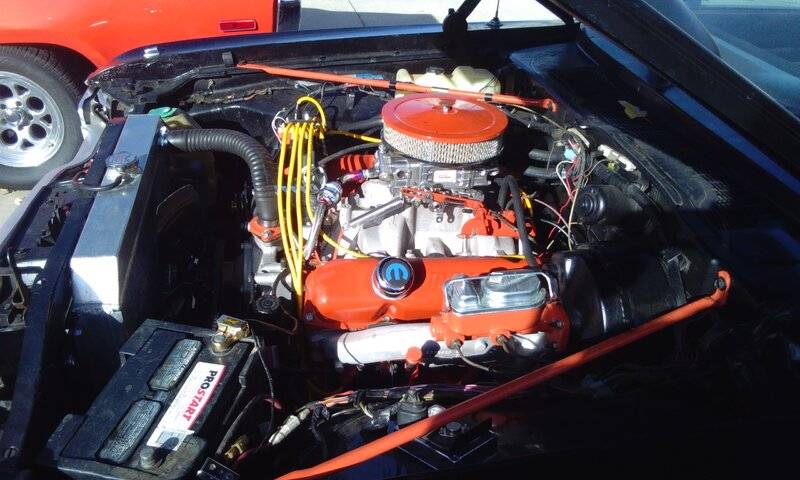

This is just some information for you. I had an 83 Dodge Mirada with a 318 in it. I put a 400 in it with standard motor mounts that I think came from a 1976 Cordoba 400. It fit with NO modifications. I also used cheep headers from Summit racing. This was in 2005. The only problem was one tube of the header rubbed on the steering column rubber insulator. Also last year, I put a 400 into a 76 Dodge Aspen using stock motor mounts from Rock Auto 77 Cordoba. Biggest problem with that was the oil pan and a couple K member cuts. We used High flow stock exhaust manifolds on the Aspen.
Robert Shaad how was the clearance between fan clutch and radiator also what oil pan did you use and do you think the recently reproduced oil pan for the big block A-bodies would gain you enough clearance in order to not modify oil pan or k member for clearance? Did you use a C-Body or B-Body drivers side HP manifold?
Oil pan was the biggest problem on the Aspen. If you want, I will ask the owner what he purchased. I did the work. The 400 was a strocker. Nasty Aspen. It is now in New Zealand. Owner loves it.
