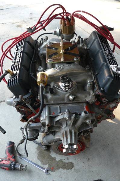

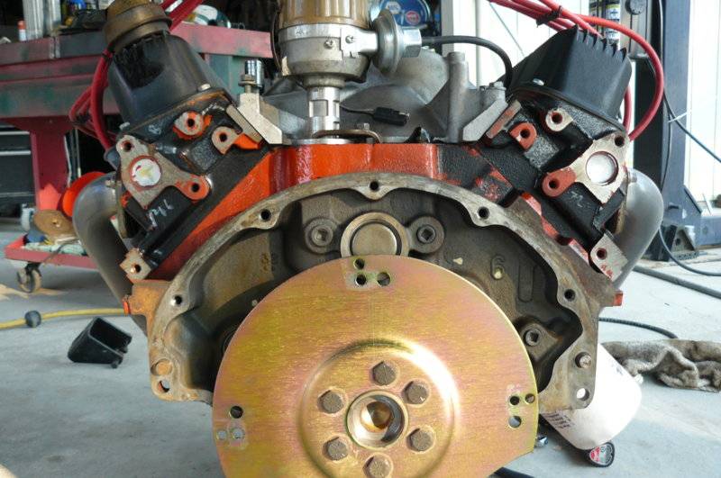

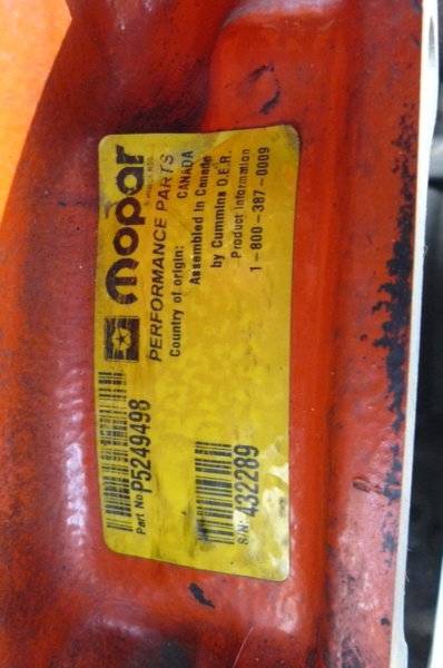

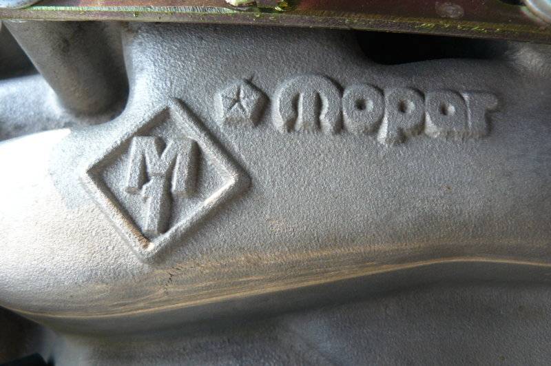

This engine has yellow tag left rear of block reads Part # P5249498 S/N 432289 Mopar performance Parts Canada Cummings O.E.R Numbers on Left front D/S bellow head are stamped 2nk under that # is 398 reading across fron 2nk is 5.9L 0742 1 205AC D/S casting # 53020006AB360 P/S casting # 07062 or 82 not sure! Is this a Magnum engine ?

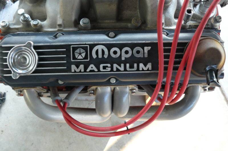

That part number shows up as a 300 HP Magnum based crate motor assembly. If it's a Magnum, it should have 10 bolts holding each valve cover onto the head.
Got any pictures?
Got any pictures?
Ok 10 bolts on each cover !
From magnumswap.com Magnum engines are factory equipped with a truck-style rear sump pan. For installation in a car, you need the mid-sump standard car pan for a 360 engine. The Magnum uses a different gasket than the LA, but the good news is that you can use one of the nearly leak-proof one-piece rubber Magnum gaskets. You should be able to buy a mid sump pan from any number of aftermarket suppliers. I would talk to Mancini first. Wes still works there but not sure if they offer a discount for FBBO. I forgot to ask when I ordered a trans pan from him a couple of weeks ago. More info here: Tips and Tricks
Because that engine comes with a mechanical fuel pump, I don't think they use the magnum front cover, they use the older A block cover behind the water pump, so maybe 1 piece oil pan gasket won't work. Magnum covers are used with electric fuel pumps.
