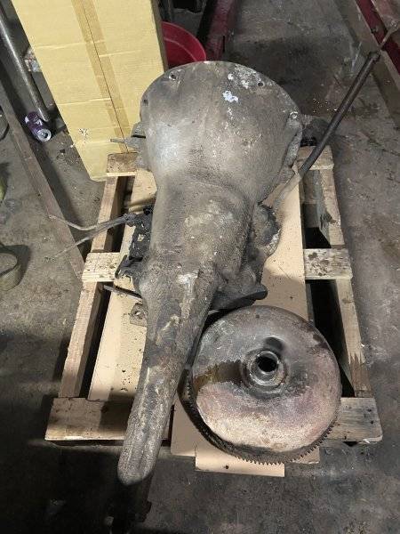

Thanks for all the replies you expertise is greatly appreciated. The next question I have is can swap the tail shafts from the 66 charger with the housing from the 75 RV transmission. I have attached pictures of both.

Should work. If its a 76 or newer the splines that go into the planetaries were made with a different pitch on the splines.
I can't imagine swapping guts from transmissions without a rebuild at the same time( unless one likes changing transmissions frequently.)
I would find a 71+ bb trans core.
I will defiantly have the transmission rebuilt. I was just making sure I could swap the tail shafts.

Make sure you use all the guts from your '66 trans in the BB case. The spline count changed on the input shaft in 1967. Using the '66 input shaft will let you keep same torque converter. The longer tailshaft housing will bolt into BB case. You should likely upgrade the 3-clutch drums to 4-clutch at this time.
