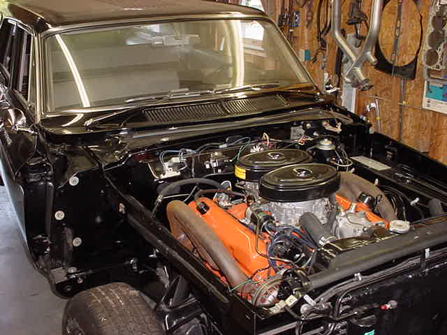

Think 62 plymouth belvedere post car. Now has a 318 poly setting between the fenders. I have a 413 with str 14 cross ram that will be going in it. What will need to be changed? What motor mounts will i need? Any cutting or changes to the K member? I don't know so i thought it wise to ask. I'd love to have original exhaust and will be looking for a pair of max wedge heads. For now tell me about the motor swap please. BTW i'm Small Block over on A bodies. Thanks
You are able to buy mounts for that to change over.No cutting or welding to K member

Easy swap.They used two V/8 K frames.The early had a seperate bracket that bolted to the K frame and the motor mount bolted to the bracket.The other had the mount bolt directly to the K frame.Either will work.
