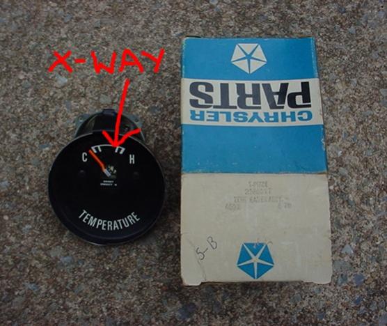

I would appreciate some thoughts about a temperature issue with my car. Driving around town it always seems to run on the cool side with the gage about like this first pic.
It doesn't matter if I am going 50mph in the cool evening air or sitting in a huge sweltering traffic jam in August (Woodward Dream Cruise!) with other old cars overheating right and left, it's still the same - nice and cool.
However, when I take it on the expressway at about 75mph and over the temp slowly starts creeping up. The hotter the day and the faster or further I go, the hotter it gets. I've had it get to about like this second pic before I have to slow down or something.
Relevent facts are mild build 440, 727, 750 holley, TTIs with 3" exhaust all the way back, 3.21 axle ratio, 26" radiator, stock fan, replaced stock thermostat and radiator cap, no obvious leaks, no evidence of coolant in the oil or oil in the coolant. Compression checks good and spark plugs all look good and the same, doesn't ping. Occasionally (maybe every 300-500 miles) I have to add some coolant to the (vented) overflow tank.
Sorry for the lack of specific temperatures. My car has a stock gage just like this handy pic I stole from ebay.

That was good thought about a bad temp gage or sensor. I don't have a laser thermometer but do have a very accurate calibrated electronic contact thermometer. After driving for about 30 minutes including some xway (air temp about 70F) the gage in the dash was reading low like the first pic. I stuck the digital thermometer probe tip right against the base of the upper hose outlet on the engine and the thermometer only read 155F. I got a reading of 151F at the radiator right where the upper hose connects.
