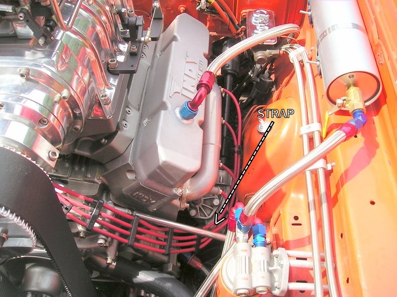

Mike, made this one , stock mounts bolted through, a clevis pin mount off of the top frame rail, to the water pump ear, worked great.

Mike, made this one , stock mounts bolted through, a clevis pin mount off of the top frame rail, to the water pump ear, worked great. View attachment 374765
MoPower...this is EXACTLY the setup I was asking about where I had concerns of the torque strap load from the engine torque actually breaking he ear off of the water pump....Please confirm how long you have been running this setup with no problems....it is exactly what I want to do...(in advance of getting a motor plate). Thanks, Mike
Hi Mike, never had any problems, for years same set up motor making close to 825 hp at the flywheel. strap is a 1/2" stainless steel with two hyme joints (fancy turnbuckle.)
