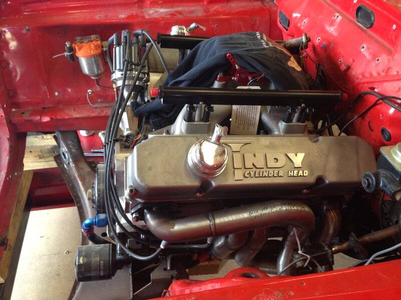

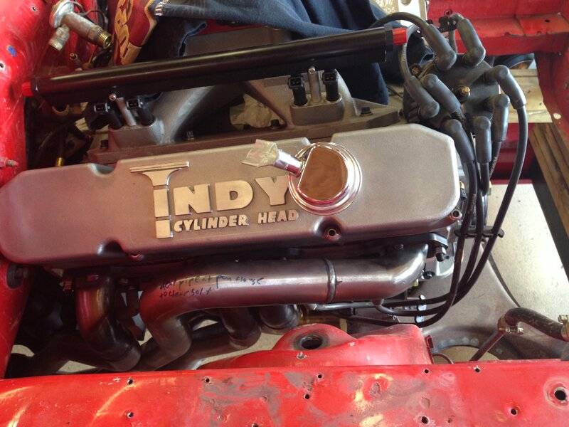

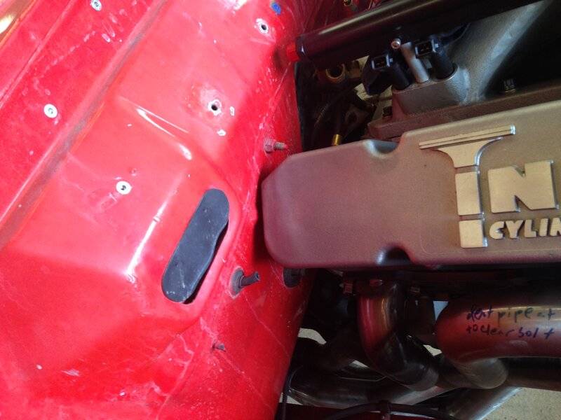

I have a lowdeck Indy engine in my 65, EZ heads sitting on a 70 k frame. The TTI headers are specific to my combo as its an Indy aluminum block. 2- 2 1/8" step headers.
