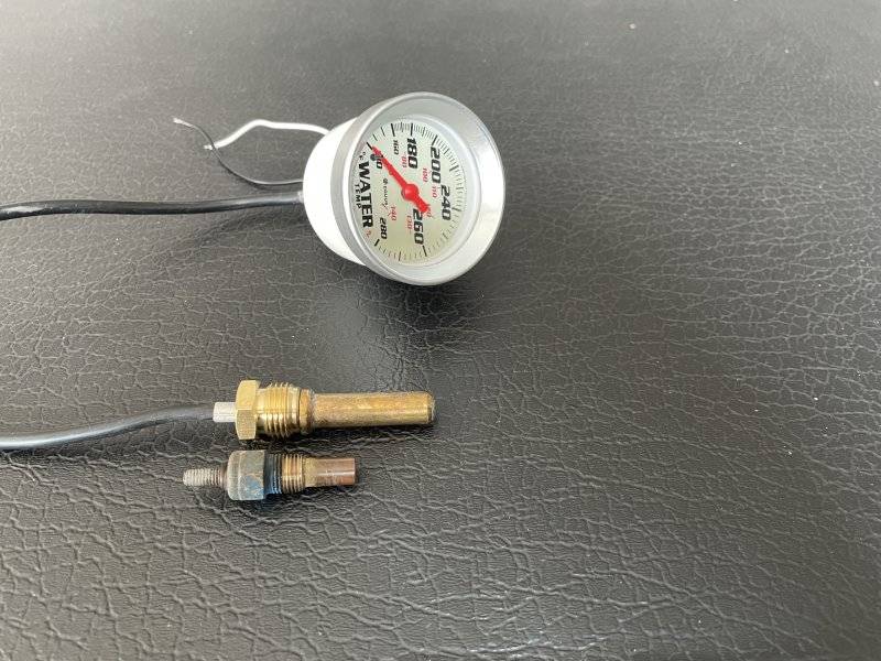

Actually tried to install the water temp gauge today.
I noticed that the Equus nut / thread is way bigger than the original water temp sensor:
I could install it in the radiator but the feeler wouldnt touch the actual coolant as the port to screw in is almost at the top of the radiator.
Any idea where the Equus temp sensor could be installed except for the original sensor location?
In your pic (post #17); the OEM sensor on the bottom is designed to be installed directly into the water with (pipe) tapped opening. The sensor shown on top is designed to be installed into an adaptor (whether open or closed style) which screws into a (pipe) tapped opening beforehand. If the adaptor is a closed style, then the void should have a high temp grease like never-seize to displace the air between sensor and well (adapter).
How about a pic of your available possibilities in the manifold especially?
