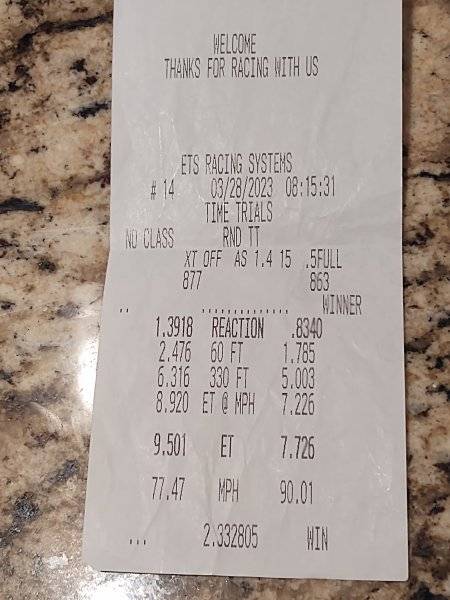

Can somebody explain this to me?
1/8th mile track and I ran 7.72 @ 90 MPH
My ET@MPH was 7.22
What info can I learn from this?
I'm a bit confused. Did you run 7.22 or 7.72.

That there's something funky with the timing system?? Not sure. Pic of the slip?

What I want to know is what information can I draw from the line that says ET@MPH 7.226
7.22 is corrected ET to sea level, most likely

I ran the 7.726 at 90.01
I am trying to understand what ET@MPH line is and what info I can learn from it for my next trip

I reread your post and figured out what you meant, sorry, i deleted that reply
7.22 is et at the first mph clock, at 594 feet. (Correct answer).
Edit: roughly .5 sec to cover the last 66 feet.
