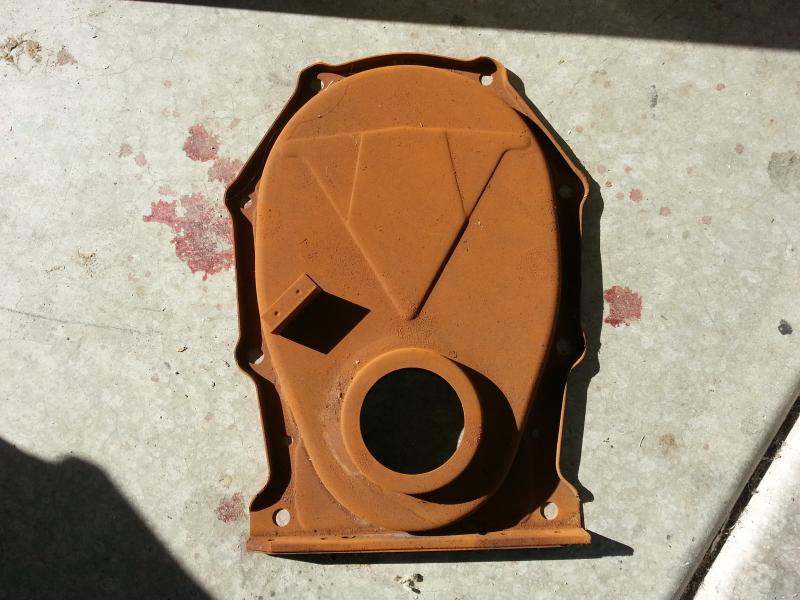

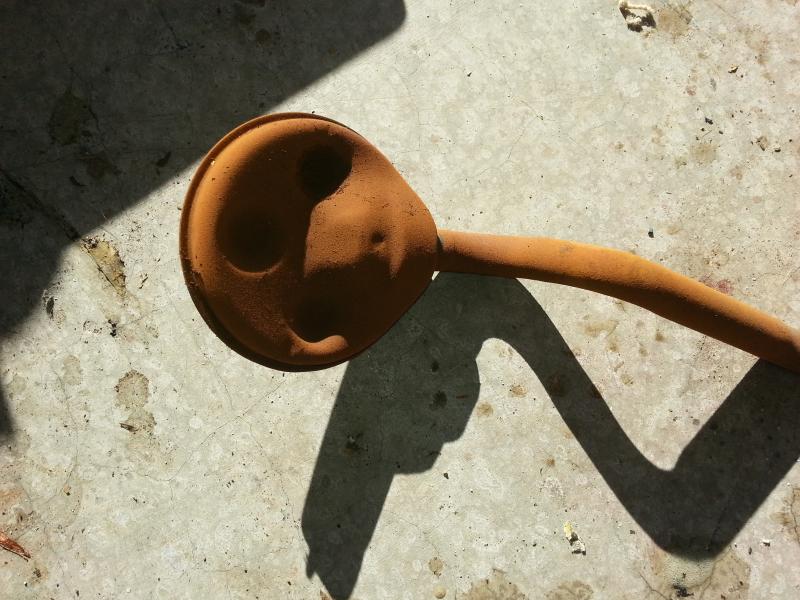

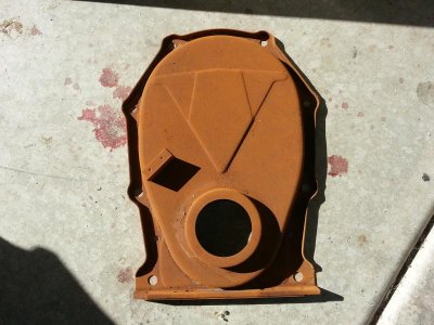

I had stored some parts in a corner of my garage and somehow they got a little wet and has a substantial amount of rust ... substantial by Arizona standards anyways.

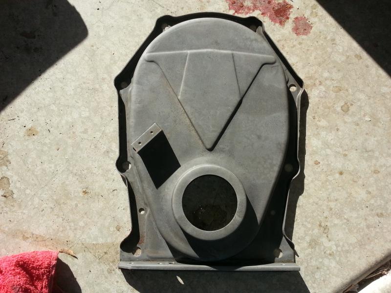

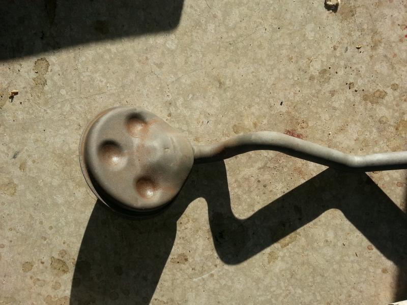

I went down and picked up some Evap-o-Rust and gave it a try ... I soaked the following items in a small tub for about 10 minutes and was amazed a how nice they came out.
