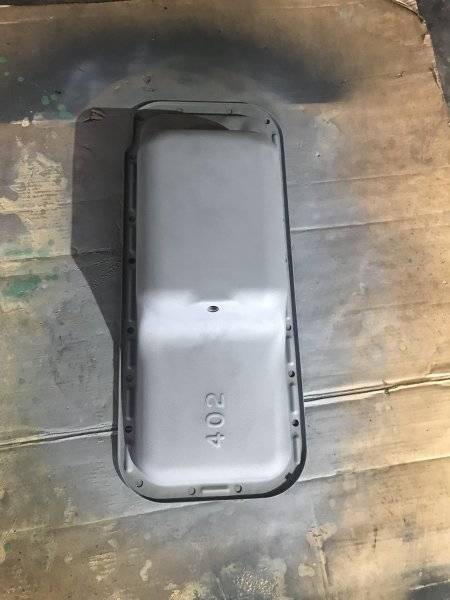

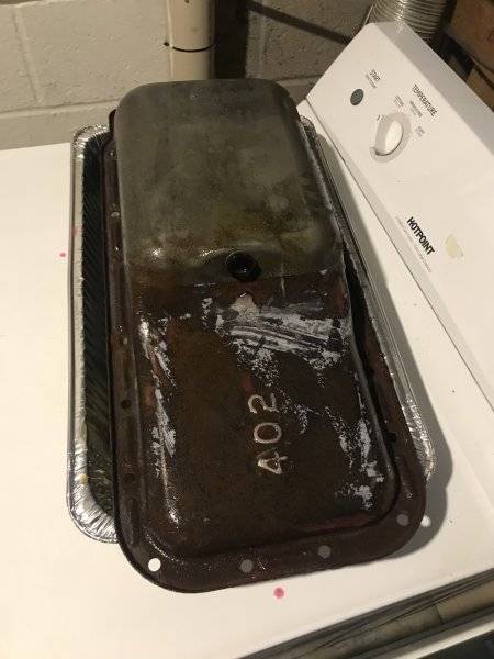

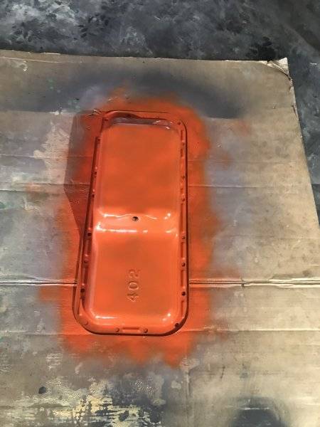

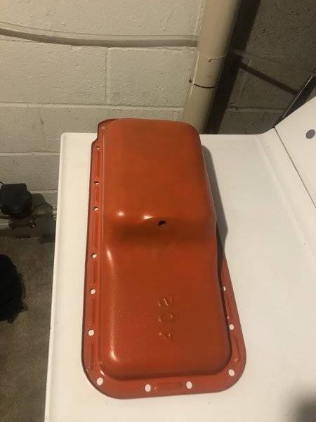

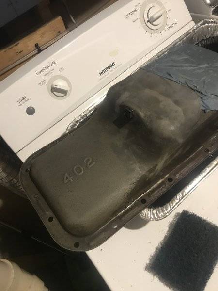

i bought a 402 oil pan for $60 and have been using Evaporust and naval jelly to clean up the rust.. They both work great. Heres some pics of the cleaning Process so far.

Yeah ive used that acid before it works but it’s strong stuff. Need to wear a hazmat suit to work with the stuff lol. Evaporust wont eat the metal no matter how long you let it soak and its reusable.
How long do you leave it on there?
Does the Boss know you're using her washing machine to rest de-rusting parts on? :D
24 hours per side slow process but it works. Im the boss in my house lol
After using my Milwaukee die grinder

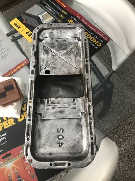

How about the rust under the baffles?
I ask this because I had one that at first glance didn’t look as bad as this, but had a lot of flaky rust behind the baffles. I ended up drilling out the spot welds, cleaning up the rust, and welding it back together.
I filled the pan with Evaporust covering the baffles. I checked under them with my borescope they look clean.
