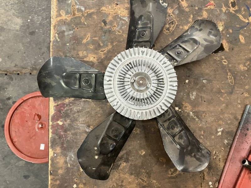

This motor has been running fine pre-A/C with same radiator, shroud, everything with no excessive noise UNTIL we swapped to the smaller AC pulley. Then the previous steel fixed fan whirred like a jet plane engine. It was recommended to switch to a fan clutch setup, which we did. Now the whirring is louder than with the fixed fan. It seems the fan clutch being an HD unit doesn't allow it to freewheel at all. So looking at ways to remedy this.

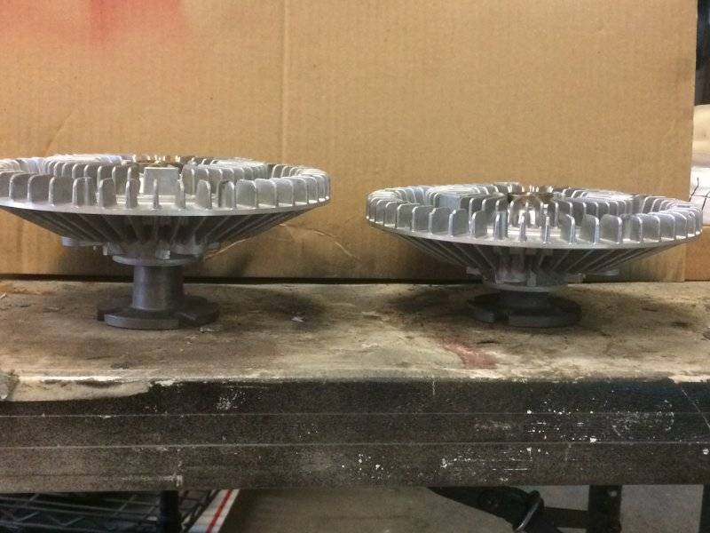

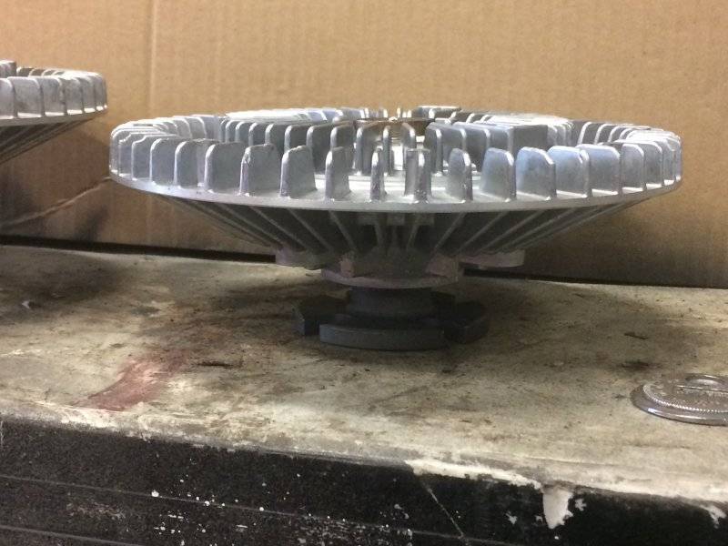

The Satellite has this unit.

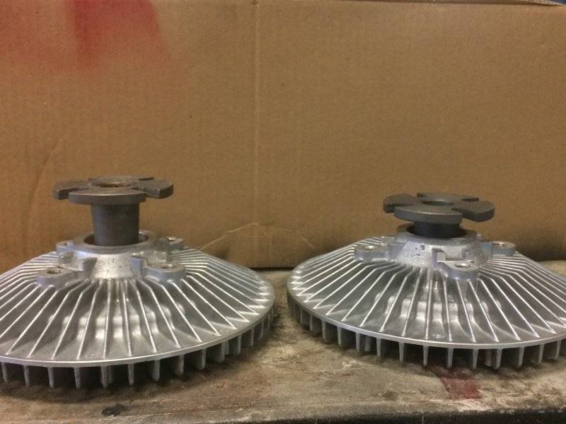

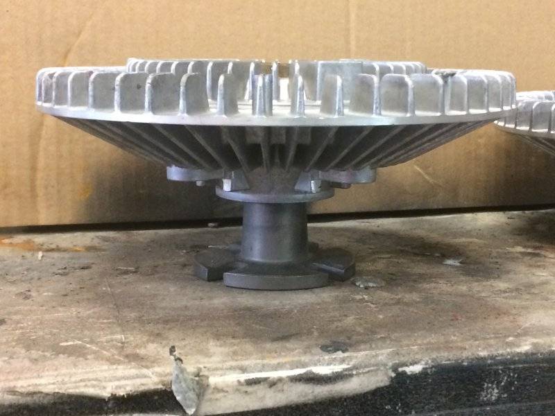

Here is a standard Hayden...I think a 2747 ?
Note the obvious difference:
Even with the stubby 2947, the ribs on the clutch are about 3/4" from the radiator core. I have a 2947 on this car:

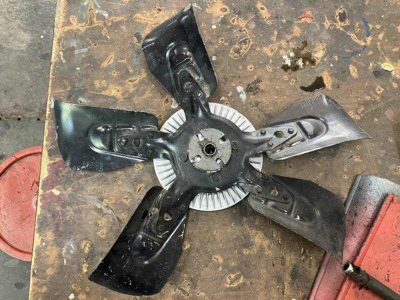

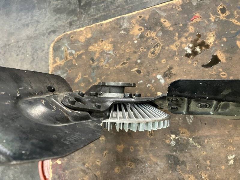

The old Hayden universal fan clutch assembly.......just because the blade assembly fits the clutch doesn't mean it will perform correctly....fit does not mean functionality. The steel 5 blade fan assembly has more inertia (wr2 or polar moment of inertia) than the 7 blade aluminum fan, and will slip sooner (@ a lower RPM) moving LESS air thru the radiator. WHY NOT USE the correct blade/clutch combination, combined with a properly fitted shroud. ......what is the jigsaw you are referring to? The next problem you'll ask about is over heating at low speeds with A/C running. Is the Hayden clutch just cheaper than the Mopar clutch?
